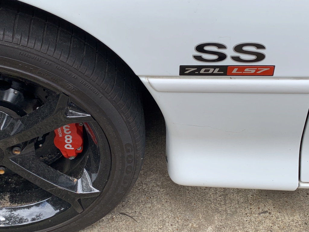

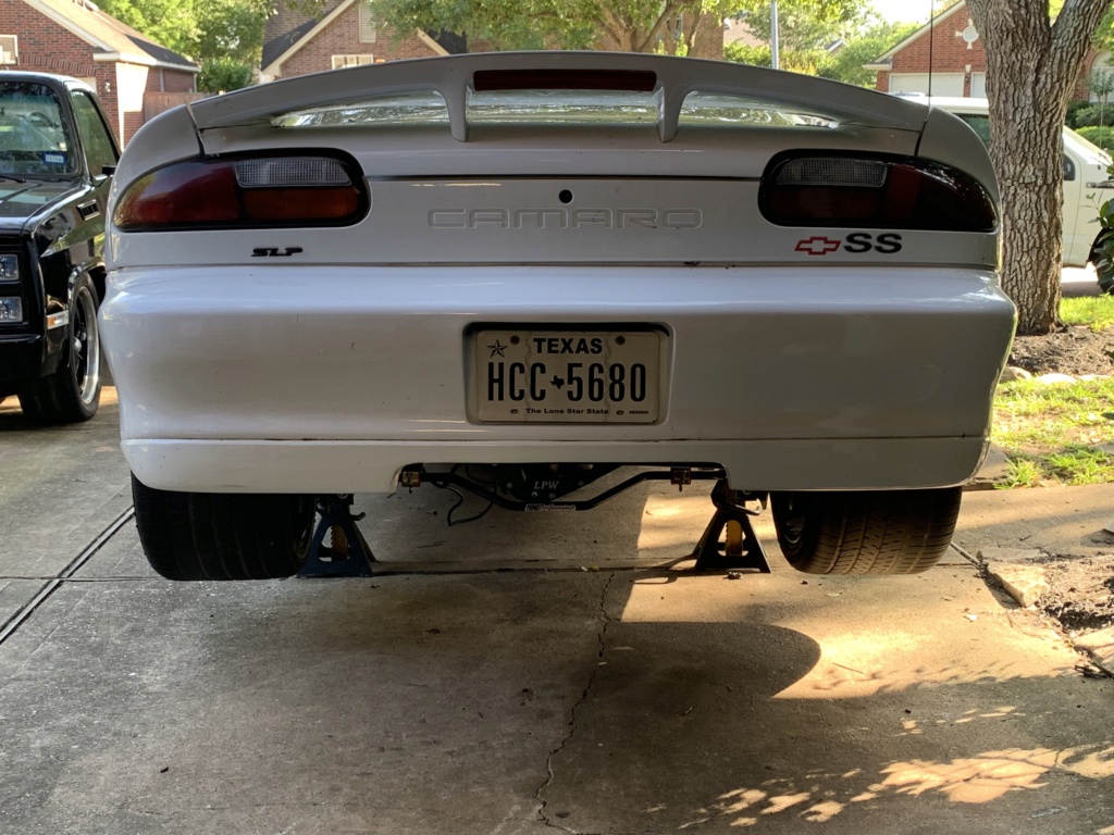

Hey. I have been working on my Camaro way more than my Laguna. I finally, after about 6 months, finished the transformation of my SS. I completely changed everything under the car. Complete UMI Suspension, Wilwood brakes,  heavily breathed on LS7, TREMEC T56, 4” Mufflex exhaust, and Dana 60 rear end. Let me just say that these are the hardest cars to work on in your driveway. I will just post a couple of pictures. If people show interest I will post some more. Cheers.

It was some money, but much less than what I was originally looking at doing. About 5 years ago I really wanted the new Z28. That was until I saw it cost $76,000 with AC. That was a big hell no. I already had the LS7 because I had bought a lot of parts from a totaled Z06 Corvette to use on my 1970 Camaro. I sold the shell of that car with all the Ride Tech suspension and kept the engine, brakes, and transmission. The brakes and transmission are on my Laguna now. So I just had this engine sitting on my stand for about 6 years. I purchased my Camaro right when I had my big hell no moment, with 39,000 original miles, and used it as my daily driver. I guess that I looked at the engine and car to many times and one thing lead to another. I was on a very large job for over a year and I just started ordering parts. I had a 1998 Z28 6 speed 20 years ago and I loved that car. Everything since then I have always wanted to build one of these cars right. Well, I did. It weighs about 400lbs less than the newer Z28,it’s more aerodynamic, and has about 125 more horsepower. As for its intended purpose, it will be my daily driver again. In the urban dictionary it’s called a Hood Ferrari. by the way, I have an LS1 engine for sale: I’m broke ;-)
