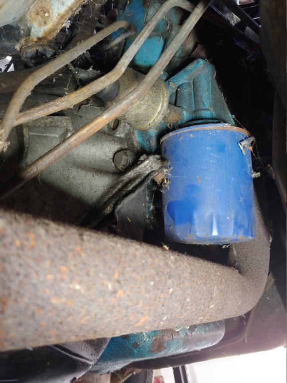

Well got a few more things buttoned up on the Can Am this week. New brake components to fix the almost non-existent brakes it had. Also did an oil change which was quite a job. Because of the exhaust, I couldn't get a conventional filter wrench on, so I tried a couple other tools and finally used the blue handled wrench to loosen it enough to take it off by hand. Not much room to work. But got it done and it sure is nice to have brakes as well.

Post by bucket Sat Jul 24, 2021 7:13 pm
Is that the same size filter mount pad as a Chevy V8? If so, you can use the AC Delco PF454 filter that is much shorter in length.
bucket
1977 Pontiac Can Am Build - Page 3 Empty Re: 1977 Pontiac Can Am Build
Post by g3chevy / Mr Pontiac Sat Jul 24, 2021 10:55 pm
bucket wrote:Is that the same size filter mount pad as a Chevy V8? If so, you can use the AC Delco PF454 filter that is much shorter in length.
Great minds think alike. I pulled out one of my AC Delco filters for my Laguna and did a side to side comparison. Unfortunately they are different. The rubber sealing gasket on the Pontiac filter is a smaller diameter than the Chevy by almost a 1/2". And the threaded opening on the Pontiac filter is about an 1/8" larger than the Chevy. But the external dimensions are very similar. I'll see if I can get a pic of them tomorrow.

Post by g3chevy / Mr Pontiac Sun Jul 25, 2021 11:10 pm
Here's a side by side comparison of the Chevy V-8 oil filter (left) to the Pontiac V-8 filter (right).
Post by Limey SE Mon Jul 26, 2021 12:33 am
Well thats a very big difference in there I wonder why ?? I know different GM divisions but you would think they would be closer than that
Post by Iggy Mon Jul 26, 2021 10:17 am
Pontiac and Olds used those type of filters.
