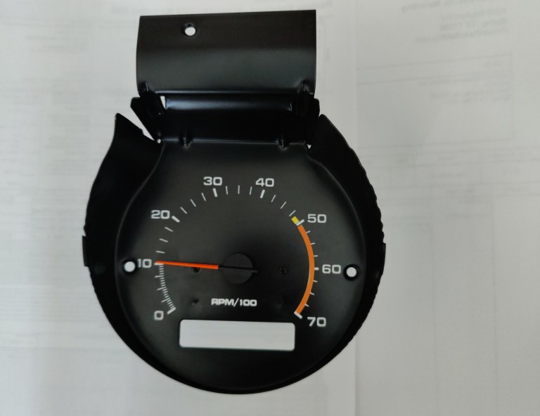

Very cool stuff! Not many folks have that many documents on their classics after all those years. Your car has some cool options. I noticed it came with the Econominder gauge as did my 76 when I bought it back in the late 80's. I updated it to a factory tach I found in a 75 Monte Carlo I found in the junkyard. You also mentioned in another thread that you were going to install a GTO tach on the hood. I've just restored a factory tach if you want to go that route. He's a pic.

jpowen49 wrote:Wish I had found this site a year ago. I already have the tach and fitted and wired it. I`m not going to mount until I paint the car.
What did you have to do to install in your car.
That is going to look bad azz!

Thank you 76Chevelle2Tone. I don`t think you`ll have any trouble selling your tach. I know there are a lot of purest that won`t like what I`m doing.

Just read the rest of your post. To install a factory tachometer with vehicles equipped with the Econominder gauge cluster you basically just have to add a pin in the gauge cluster harness plug that mates into the flexible printed circuit board on the back of the cluster. Then you simply run that wire to a tach filter on the firewall and then the tach filter lead goes into the HEI plug marked "tach". On 75 models, the pin was already installed from the factory when the Econominder gauge cluster was ordered. Then that wire ran to a pigtail mounted on the gas pedal bracket. So then all was needed was a tach filter and one end of the filter ran through the firewall to that pigtail. Hope this makes sense.

I understand what your saying. I have replaced my wiring harness and had to use my old plug because they are obsolete. I have a couple more gauge clusters and printed circuits with gauges as spares .Are the tach filters still available.

Here is a generic filter that will work for our tachs.
