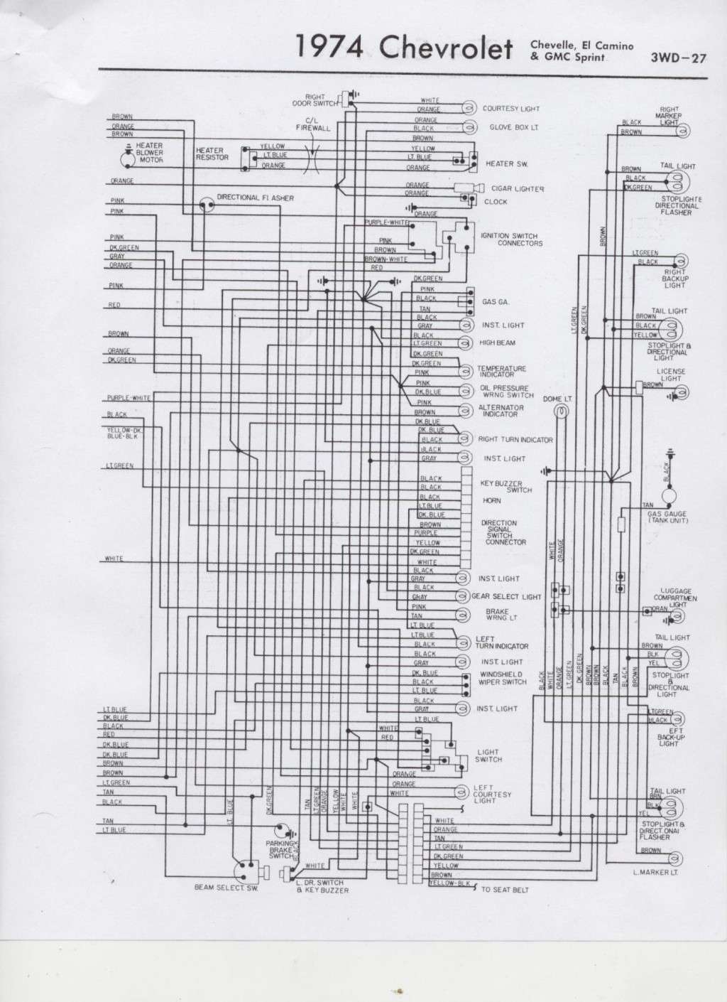

i havent traced the wire but what does that dark colored wire go to? it sparks when i pull apart the plug at the bottom of the steering column and is causing my battery to die cuz its draining?

Post by bigredlaguna Sun Mar 07, 2010 8:33 pm
The schematic I have doesn't have the wire colors exactly in that order, but basically any wire associated with the turn signal switch is part of the lighting system and that color on the schematic I have is a marker or turn light.

Post by Limey SE Sun Mar 07, 2010 8:41 pm
help with turn signal switch??? 74wiring2

Post by cromags76 BANNED Sun Mar 07, 2010 8:44 pm
Limey wrote:help with turn signal switch??? 74wiring2
now if only i could get rid of the blur and get out my magnifiying glass

Post by Limey SE Sun Mar 07, 2010 8:57 pm
help with turn signal switch??? 74_wir10

Post by bigredlaguna Sun Mar 07, 2010 8:59 pm
My mouse has a magnifier Razz That wire is to a turn signal.
