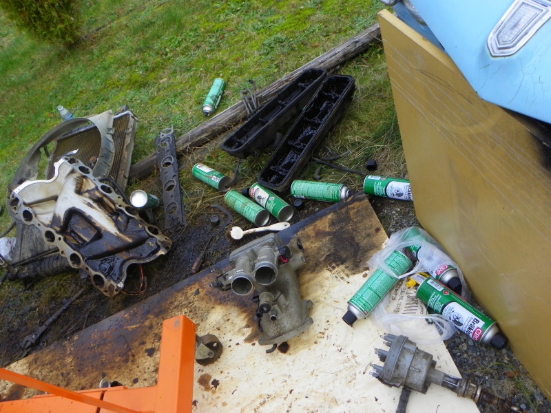

just to clean the parts that are beinge reusedd...pulleys, intake manifold, valve covers ect ect, we used 2 gallons of carb cleaner, 3 gallons of gasoline and about 20 cans of brake clean. and learned that the compressed air for cleaning keyboards sprayed across a propane heater makes a very good flamethrower
