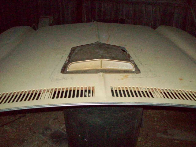

if you can wait till I pick up my shaker in a week or two .......... I will make a cardboard cutout of the hood hole when I pick mine up

you will need this as well for the scoop

Surgery begins !!!!!!!! Open her up !!!
Still need to trim on some of the bracing under the skin .. What do ya think ????????????

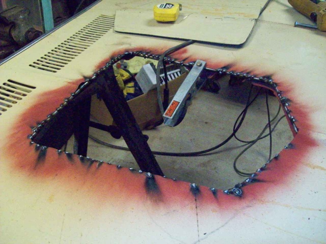

3 saw blades, 1 busted knuckle, 13 cuss words....... PRICELESS !!

What did you cut the hood with? I tried to put some holes for hood pins thru the hood and thought I never was going to get thru. I want to cut a hole about that size to put a Thunderbolt scoop on my 78. JB

Good skinny jigsaw blades,, Nice and slow.. broke some.. lol

The inner bracing gives ya heck because It is uneven !

My oldest son had a '70 Trans Am with a shaker hood. I use an air cut-off tool to cut holes like that, with a 1/16" X 3' cutting wheel. It works great for the straight cuts. The curved cuts are another story.......aircraft sheet metal shears, which take two hands to cut the stuff.

A little progress
Added some 3/8 cold roll around the lip of the cut out to give It some strength and a finished rounded look. I will flip it over and trim the under side to clean It up. The red in the pictures is weld thru primer.
