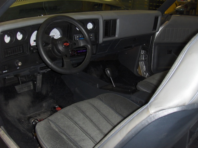

I dig the color combo, but man that dash setup just blows it all away! I love how you went with the white gauges & silver dashpad to break up the interior. Beer

Please do a write up on the dash work you did budman that looks like you put alot of time into it. Love all the detail work you have put in. Nice to see that you painted the under side of the fenders to protect em from rust. The frame looks good as well.

Thanks for all the positive comments guys. The frame is all POR-15 with some parts coated with gun metal gray. (more pics to come of that I didn't have my other card) The underside and inner fender wells are Rhino-lined (smooth finish) with a UV spray for easy cleaning. The dash well lets just say started as a disaster. I bought the world famous dash cap to save some money. A local interior guy told me to throw away the glue it comes with and use windshield urethane. Worked good its not coming off, but I didn't like how it fit around the vents and corners. I wound up taking it to probabley the best interior guy in our area and we mathed the vinyl on my seats and doorpanels. Believe it or not that is one piece of vinyl (no seams) He did an awesome job. Then I painted all my vents, dash bezel, tilt, turn signal, inner door handles and glove box handle black. The white gauges are that kit you find on Ebay and worked great. Good quality graphics on white vinyl. Thanks again for the comments. I'm no expert but if you have other questions feel free to ask.

Vinyle on the dash in one peice wow he did a great job.

I have a dash prepped to do the same. Waiting to order a dash pad at the moment. What grain & grade vinyl did you use? The car looks great! Hope I get there too someday. Very Happy

77mali, I would have to check into that info but he did tell me I wouldn't have needed the dash cap. He said he can fix the cracks and go right over it with a very light padding and vinyl. Jedediah, look at the pics close. I sh#t you not no seams. I was very impressed with his work.

Budman, if you can ask him when you get a chance, that would save me a whole lotta research. I think they use a compressible foam filler that's glued to the top of the dash and then use a lightly padded vinyl too in order to make it look that good. Thanks!
