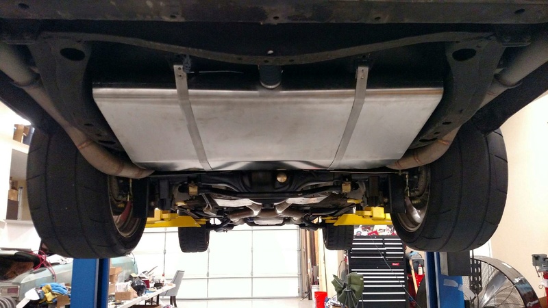

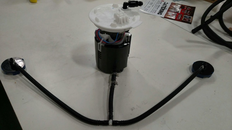

New gas tank:
- Ricks Stainless tank
- 23.5 gallons
- Notched corners to clear exhaust
- Dual Cadillac CTS-V Fuel Pump Assemblies (2 pumps per assembly)
- Dual Corner pick-ups for each assembly feed the main bucket. So even with 1 Gallon in the tank and cornering, it will not starve for fuel.

Post by Joe73 Wed Sep 28, 2016 2:12 pm
Nice work. I love the smooth look of that tank.

Post by Limey SE Wed Sep 28, 2016 6:13 pm
Wow That Tank is Super duper Nice Buddy That is going to a Very Very Nice ride when your Done (well already was ) But great Improvements

Post by fasrnur Wed Sep 28, 2016 8:49 pm
Very nice. Those pumps should be able to supply enough fuel huh?
I like the tail pipes too. That's the way I want mine to be routed. By the looks of it, it was very labor intense.
