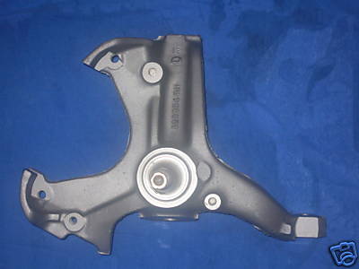

im not sure but i think firebird/camaro suspension peices might fit on our cars. i read somewhere that chevelles took firebird and camaro suspension features so i think they might work
this is a chevelle stock spindle
this is an aftermarket firebird camaro 2" drop spindle

there fixed the pics for ya

just from the pics i am gonna have to say no, they wont interchange, top and bottom of the camaro spindle more even up up and down ...........and the chevelle has a longer bottom arm, and that back where it bolts up has more of a V type slant to it on the camaro one as well. BUT thats just my observation

stock camaro spindles

ok it got rid of the V angle problem but it still doesnt look ike it will fit in the front area
Re: 73 firebird/camaro suspension same as 73-77 a body? (maybe)
They do use the same spindle. I used the Mchauhey's 2 in drop spindle for camaro/ firebird on my laguna. I was able to look up the original part #'s, and they were the same.

the spindles are the very same part, and i think even the control arms are the same- but the steering linkage is different due to the difference in track width.
