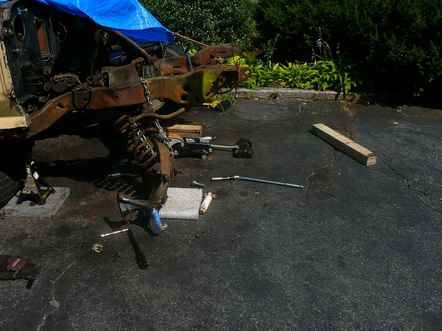

Im trying to take off the front suspension with the engine out. I've never tried to break ball joints without the engine. I'm a little nervous, because even with the floor jack under the lower control arm, every time I loosen the nut little by little, I can see the whole spindle going down with the nut,, like you would expect would happen if you didn't even have a floor jack under the arm at all. I have the floor jack pushing up high enough that the frame of the car has lifted off the jack stand, so I cant do any more than that with the floor jack. I have those spring compressors but I've never used them, never had to. I can't get them to fit up in the inside of the spring or on the outside. This is just feeling a little dangerous, and I dont know if my extension cord "chain" is going to work.
any thoughts?

That's some scary stuff you got there. Do you have a good heavy chain to bind the spring while its got at least a small load on it? I rented some compressors from Advance and they fit ok for me. They looked a lot less sturdy than yours also though. I was uneasy to say the least.

If you plan to remove the lower control arm- Secure the spring with the compressors you have & use a good strong chain too. If the spring let's go, you could get seriously hurt of worse. Scariest moment of my restoration so far is when the spring popped.

If your not planning to reuse the springs cut them in two places. (Torch works best) that will relieve tension. Be be forewarned it will be darn near impossible to put the springs back in with no engine. Good luck

The chain in the pic I posted was a bit long & it made a big pop & hit a wood block I was using under the lower arm. The spring hit & moved the wood! (see pic) Good thing I was in the engine bay compartment. SO BE CAREFUL!!!
When I go to do the other side I plant to compress the spring just a bit to make it easy to get it loose from the lower arm. Will also put the chain on so it's tighter against the assembly. It's kind of hidden at the bottom in the 1st pic but it's threaded through both the spring and he lower control arm.
(Also 2nd pic is after compressors were removed)

A safer trick I've learned with the mentioned compressor from Advanced Auto is to actually not to use the finger/claw that floats up & down the shaft bolt & only use the threaded finger/claw. Insert the shaft bolt & washers(with a thin coat of oil)down from the top side from the frame where the top of your threaded shaft on top of your shock would normally be. Then place the threaded finger/claw inside your coil spring as close to the lower control arm as you can. This method is much easier than going up from the bottom side messing with both sets of fingers/claws. This way allows you to compress the spring back into the frame allowing the lower control arm to move freely without any tention & dealing with a coil spring/compressor in your way during the process. Resistance is held against the spring pocket within the frame. This also works very well for reinstalling as well.

What happens when the spring is longer than the bolt? Dont think i would want to find out.jmoLSANTI76 wrote:A safer trick I've learned with the mentioned compressor from Advanced Auto is to actually not to use the finger/claw that floats up & down the shaft bolt & only use the threaded finger/claw. Insert the shaft bolt & washers(with a thin coat of oil)down from the top side from the frame where the top of your threaded shaft on top of your shock would normally be. Then place the threaded finger/claw inside your coil spring as close to the lower control arm as you can. This method is much easier than going up from the bottom side messing with both sets of fingers/claws. This way allows you to compress the spring back into the frame allowing the lower control arm to move freely without any tention & dealing with a coil spring/compressor in your way during the process. Resistance is held against the spring pocket within the frame. This also works very well for reinstalling as well.
Re: Is this safe? trying to remove ball joints with no engine in car
Great point...thats why its important to have the finger/claw at the lowest part of the coil during removal & reinstallation. I've used this tool both ways with past coil spring projects & have found going in from the top side has worked out better.

thanks for all the responses guys. I did the upside down trick thru the frame/shock hole and that allowed me to get enough spring compression to lower the arm down. It did tweak my harbor freight spring compressor rod and I messed up the threads on the other one last night by running it with no oil or grease. Anyway, one side is disassembled without drama.
I just didnt have a spare chain around, so I added to my electrical cord a ratcheting tie down strap , and then I put a big huge pry bar down thru the spring and the lower control arm, thinking that if the spring did let loose, i doubt it would easily take the pry bar with it the way I had it wedged in there.
I even found guys on the net talking about in this scenario to put some kind of beam or 2 x 4 between the top of the frame and a rafter in their garage to enable them to do the standard floor jack method.
So on my other side I now have no spring compressors to use. I think I'm going to go with the pry bar thru the spring/ arm ,, and 2 or 3 tie straps wrapped thru the spring, lower arm and frame, still use a floor jack under the ball joint, and keep my safety glasses and mouth guard in!

I was just gonna suggest putting the pry bar through the spring. Used to do that trick when changing springs, put a pry bar through the center and stick a pair of vice grips on the bar about halfway up...at least then the thing don't go flying out and decapitating anyone.
