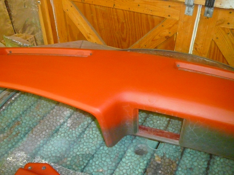

Well I got my quote from just dashes. $1200. Ouch! I might get strung up if I spend that much. I decided to try a dash pad. It came in last night, don't like the fit. It is about a half inch short of the AC vents and its short at the bottom. So plan to try something else. recovering my dash myself. I ordered some stretchy vinyl and I think I will put a real thin foam at the top and front to sort of cover where cracks exist. then I will glue and stretch the foam into place. I think 3M super trim adhesive should work if it won't damage the vinyl. Any opinions on this idea? I won't even care if it wrinkles around the underside of where the cluster goes. it should still fit better around the vents and defroster then that pad does. I have to go pick up a heat gun and some foam and glue. I'll do a little test to see if the adhesive will distort the vinyl or make it lumpy. ugh.

Use vinyl top adhesive from Dap for the glue that other stuff will not hold down the line.Also use landau top foam. You can glue it with same adhesive. Scuff it with a 60 grit disc by hand just enough to take the shine off or glue wont stick.
Start in center and work your way to sides. spray adhesive on both vinyl and foam top (After foaming is dash is done). Lay heavy plastic down with a small opening in center so you can slide plastic out to each end as you go or it will all stick and your screwed.
PS I wont do it and I used to do this for a living. so curious how it will come out.
PS they make 4 way stretch vinyl now days. A heat gun will help at corners before sticking it down.

You can also get the "levant" or "Elk" style vinyl top material to use as a cover. Â They come with the white backing on it. Â I'm planning on using that but instead of foam between the dash pad and the vinyl- I filled my speaker holes and repaired cracks using the fiberglass (short hair type) filler. Â I also used a brace on the underside of the dash pad about 2" away from where the speaker holes were, centering it along the top to almost the end of the dash pad on the drivers side to keep it from flexing and re-cracking. Â It was a lot of work but worth it in the end. Â You don't need anything fancy for the reinforcing I just used a flat piece of 2" wide 1/8" thick stock and drilled several holes and you have to bend it slightly with the contour of the dash. Â There is plenty of meat on the underside to get a few short screws in there they were either 1/2" or 3/4" long can't remember exactly now LOL.

Here's a closer up of the center section. Â Those weird looking lines that look like cracks are a reflection from the flash on the table top I was using to turn the dash pas while priming. Â I always HATED that dang center speaker. Â The design was terrible and was why so many of these chevy dash pads failed.

The dash is covered with foam and has a piece of vinyl vacuum formed over it. Â Are you removing vinyl & all the foam from the dashboard? Â I thought the repair would be grinding back the cracked area, re-foaming with something like spray foam, hot knife/grind/sand the correct shape, and then reapply vinyl over everything. Â Landau top foam is in a roll, so are you covering the entire dash with landau foam and then vinyl? Â Fiberglass filler, why, over the whole dash? Â What if you wanted to keep the speaker holes? Â Redrill them afterwards? Â How is bracing the back of the dash going to prevent the sun from drying/cracking the vinyl? Â Do you have a picture of the bracket/mounting? Â Maybe it will make more sense if I saw the bracket.

Jerry- I didn't use any foam for repairs or the 3m stuff such as was used on the "Blue Collar Buick" rebuild- just reinforced fiberglass filler. Â I'm sure a company like Just Dashes would give you a true factory reproduction- correct grain and all. Â In my case, with a limited budget for dash reconstruction, I found that the products I used worked well enough to get it back to a smooth crack free surface for the vinyl covering I plan to use. Â It will look nothing like the original dash-pad when it's done. I'll take a pic of the reinforcing brace & post it. Â I don't have one in my stash. Â As far as protecting it from the sun- I'm getting one of those reflective folding things. Â It should be fairly decent on it's own though as it is the stuff they use to cover roofs with. Â The stuff I bought has the white padding as a "backing" on the vinyl itself and it's not foam just a textile. Â It came from Chicago or Michigan...I'll see if I can find the info for the manufacturer. Â I got the "Levant" Grain which matches the grain on the "Saddle" top that came with my car.

Paul, so the orange isn't the final surface? It looks good. I never thought of fiberglass overall. My kids wouldn't be able to poke through fiberglass.
But, when you apply the vinyl, you are gluing it on? I thought vinyl was heat shrink or vacuum formed.

I'm not sure it can be shrunk or vacuum formed but yes it will be "glued & stretched" into place. This particular vinyl is about an 1/8" thick with the backing material. My only concern at this point is getting it to look nice around the vent openings but I plan to go over everything, let it dry/set and then cut it afterward from the back-side. leaving enough material to pull back, get tight and mechanically secure. I'll PM you some pics so not to hog up the thread, unless ratnfested wants to see them also.
