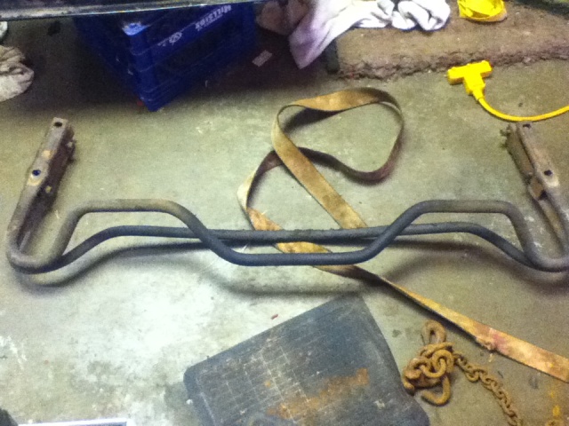

you should try and find a caprice rear sway bar. they fit perfectly.

i changed mine when i put the posi in

I can vouch for the sway bar as I have one from a '95 impala SS on my '74.  1 inch vs 7/8 factory. A nice improvement for a lot less than a aftermarket replacement.  Mine was $40.00 from the bone yard.
