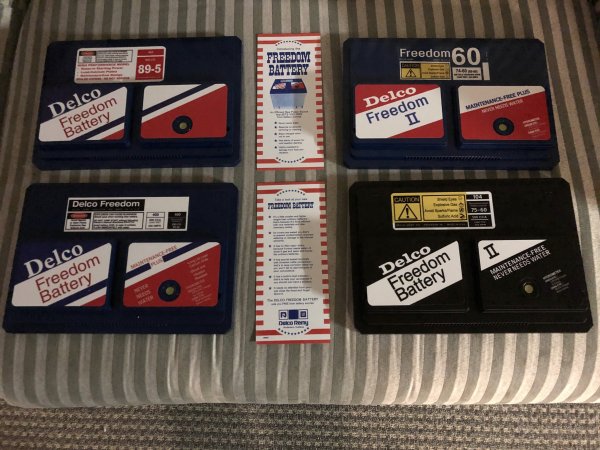

Joe on one of my Other forums They Just offered for sale the Topper you are talking about Let me get Link
Re: 1973 Chevelle SS, 350, 4spd. build
Joe I dont know what years these are for so Forgive me for that
For a limited time, you can get your choice of the 4 toppers avail and a free battery brochure, these are hard to find, some cars had them in the glovebox paperwork. 1 topper, 1 brochure, $65 plus $15 Priority ship in the CONUS. ( includes $50 insc insc. if more is needed, you can add more if you like. ) 2 toppers can ship for the $15, but only has $50 insc.)
Get your car ready for spring. These toppers fit a 78 series battery, white interstate battery’s looks closest to factory, smaller battery’s will have a slight over hang on end. But hardly noticeable. hurry, this deal won’t last long.
Eye is not a decal, All 4 toppers have the 2 pc plexi eye that looks real.
You would have to google what years, what batteries were available and used in what models. I think those toppers are for cars in the late 70 early 80s but you would have to check. I have the R89s for the group 78 battery. Side terminal. That was stock for 73.
If my memory is correct, I’m pretty sure that my fathers new 1977 El Camino had one of the two batteries on the left side of that picture. I remember my dad and grandfather trying to figure out what the little green lens was for. At 9 years old if they were under the hood so was I!!
