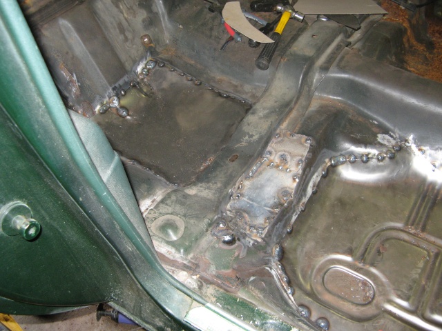

Those hat-section support members appear to be solid yet, which is a good thing for sure. It just takes time and patience, from what I've learned. Do you have a MIG welder ? That seems to be what works good. I gas welded all my repairs, since I use that type for aircraft work.
Have fun !!
Have fun !!
Re: project nightmare begins.
well the guy that had the car before me installed new quarters, and what was weird to me is the pans and cross braces and rear shelf/package tray was so rusted/rotted but the rockers and stuff seem to be good and solid i figured those would be a goner too but guess not. luckily my in laws own a few body shops and they are gonna give me a hand with the welding.and youre right on those torx bits, got all of them off but a few and they striped out, had to cut the back seat out with a saws all lol. seat was a goner so it was ok.

The floors get ate up mostly from water/moisture on the inside, and not so much from the bottom. I had only a few holes to weld patches on in my Elco floors, and laid a layer of fiberglass cloth & few coats of epoxy resin, on the floors before painting. At least the water & moisture wont get to the metal so much.
A friend did an S-10 resto, and used bed-liner on his new floors, which I think will work quite well.

well finally back with update, got the floor in,and its been primed and decked a few times now, and also was able to get the taillights like they was suppose to be and not full of bondo and shaved flat. should be painting in the next few weeks.

thanks guys, the floor was a pain, had to fab a lot of stuff by hand.out of all the work thats left im dreading the bumper and dash install the most lol.
