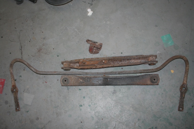

Did some minor chassis work today. I already replaced the upper arms w/ adjustable Spohn arms but the stock lower control arms were quite rusty, just about rusted thru and the rear 3/4" or so sway bar was in my opinion an bit anemic. I opted to install a set of '96 B body lower control arms and 1" plus Impala SS rear sway bar. I had the parts department at work order the control arm kit, it was like 46 bucks and included both lower arms, (4) control arm bolts w/ nuts and all the hardware to install the sway bar. The bushing sleeves are .160" longer than the 73-77 A body arms and the bolts are bigger, so the holes in the rear diff housing and the lower control arm frame brackets needed to be drilled oversize and the bushing sleeves shortened .080" on each side.
New lower arms and Impala SS sway bar:

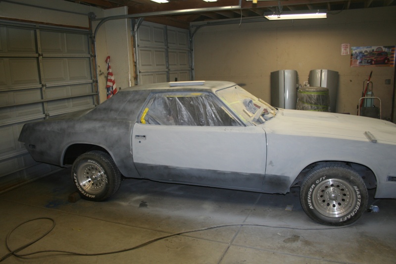

The front wheels and tires showed up today:
Startin' to look like this one:

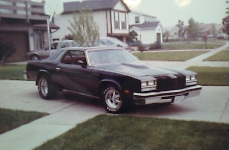

Air shocks in it? Looks like its coming along great. Just wondering are the Cragars exactly like they were or did they change at some point just a little? They seem different now.
Re: '76 Cutlass High School tribute restoration. Update: frame swap.
Looking wicked Dave! Love the Cragers!
ant7377 wrote:Air shocks in it? Looks like its coming along great. Just wondering are the Cragars exactly like they were or did they change at some point just a little? They seem different now.
Yup, air shocks w/ adj. upper control arms to keep pinion angle in check. The wheels are the same diameter, width and offset. the tires are not the same brand. I had Widetrack Radials on the high school one, which was a Farm and Fleet sold brand. I think The BFGs have a little more rounded tread to sidewall transition.
They look about the same to me. I think the old photo is just fuzzier with somewhat different lighting.

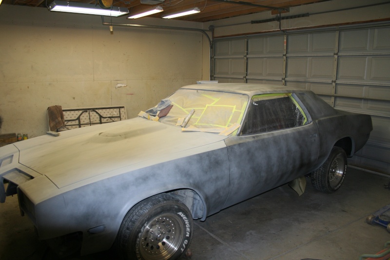

Spent the weekend blocking the entire car again this time w/ 320 grit. I ran out of dry guide coat so I mixed up some over-reduced DBC basecoat and dusted a thin layer on prior to sanding :
final guide coat before disassembly for paint:
Next pics should be disassembly for paint and panels getting color.
Dave W.
Dave W.
