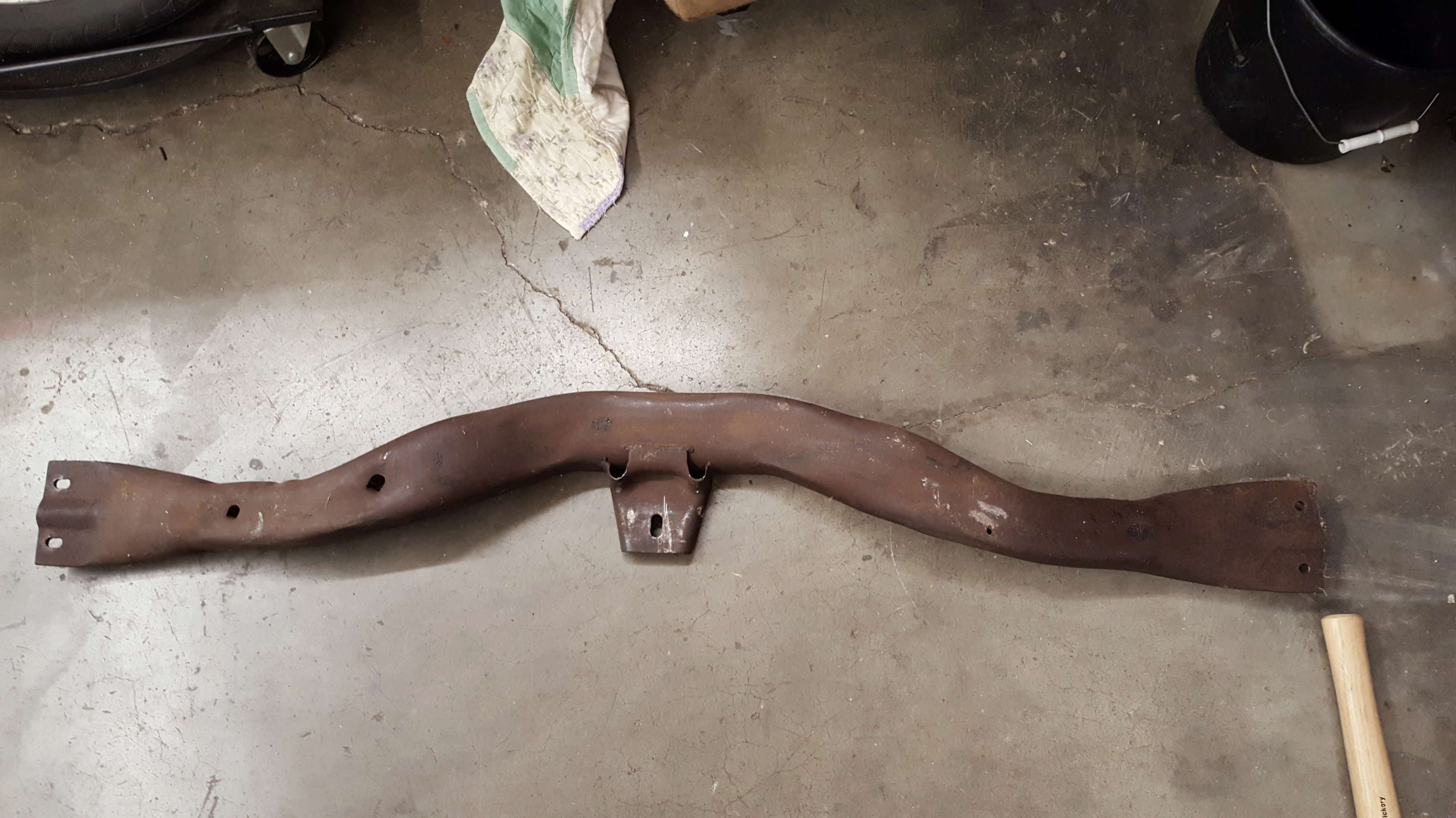

KC77Monte wrote:
Not sure what is out of. I bought it off Limey so it should fit. I'll throw a tape on both just to make sure. Thanks
Take a pic of it for me I don't remember it KC77

Post by KC77Monte Thu May 31, 2018 11:27 pm
Limey SE wrote:
Transmission Crossmember 20180510
KC77Monte
KC77Monte
Transmission Crossmember Empty Re: Transmission Crossmember
Post by Limey SE Fri Jun 01, 2018 11:47 pm
I removed that one from the 76 Lime Green Malibu I had to swap out for a DD
