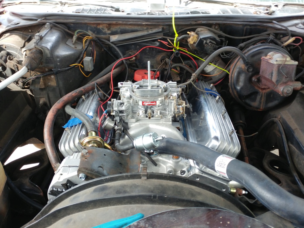

With another weekend and a little more good weather i got a little more accomplished. I popped under the car with the intent of finishing up the exhaust. Little things like installing new hangers and clamps and making sure everything was aligned properly. I noticed it looked a little off but couldn't put my finger on it so off to google i went looking for specs and pics. Come to find out i had the mufflers in backwards ... DOH!!! So 3 hours later the passenger side is back in and aligned. I also figured out i need 1 more hanger on each side. The moral of the story kids is be prepared to redo any part of a project this big ... lol.
Once I had that done i was feeling a bit abused so i decided it was time to sort my carb and linkages. After a very great deal of fruatration with not being able to get my spacer plate mounted i realised that this intakes holes were tapped to a different depth so the hardware i had wouldn't work. Eventually I decide to just toss it and mount the carb directly.
