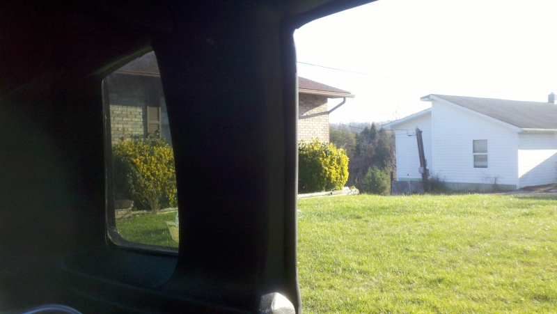

first image you can see the b pillar chrome sticking out behind the original rubber. Second pic is of the METRO waaaay to fat to see the chrome.
Landonus- Donating Member
Re: Weatherstripping
Notice the gap at the top because the rubber on the B pillar that meets the door is so thick, also the thickness on the A pillar causing it to flare out. Am i crazy or is this a truly faulty product?

not sure but I think you may need to adjust your glass in the frame, it doesn't appear to fit the framework very well ????????Landonus wrote:Notice the gap at the top because the rubber on the B pillar that meets the door is so thick, also the thickness on the A pillar causing it to flare out. Am i crazy or is this a truly faulty product?
there are stops inside to adjust the distance the glass travels ( I think )

I forgot to take a picture of the rubber at where the door meets the post. The rubber there along the pillar with the push clips in it was solid and very thick. That is why the glass is so far out. I think it might have messed something up because I had to leave it on there about a week until the new rubber came in the mail because the old was unuseable. But I always shut the door while it was rolled down and rolled it up and got out the passenger side. It was so thick I thought it was going to break it. My window now flops in and out when the door is open or not rolled all the way up and may be why it is not sealing correctly now.

Regarding window adjustment I'm probably the wrong guy to ask Spent like 1 1/2 hrs fiddling around with adjustments, which there are quite many of. There must be a procedure for how to do this, but I didn't have any.
For a start you of course have to remove the door panel. Then the spots marked in red in the picture will adjust the window motion... in every thinkable and unthinkable direction
I believe that any new gasket will require more force to shut the door until it settles in its grove. Regarding opening and closing the window, mine was still pretty hard to close with the hand crank one month after I had installed the new weatherstrip. So I just opened the door to close it completely. Now the car has been sitting for like 4 months, so I guess it's settled even more. Maybe that vaseline trick helps as well, didn't think of that.
