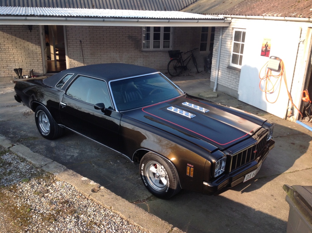

And here she is in all her glory for those that dosent know wanda.
