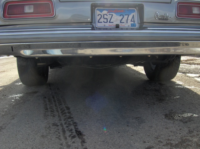

Just FYI. Â I'm running a 15x10 rim with 50 series rubber. Â They have a 4 1/2" backspace. Â Pics show how she looks. Â But my current rear (monte rear) is 1" wider than my stock chevelle rear. Â So figure they can tuck another 1/2" on each side if you have a chevelle rear. Â Just FYI.
