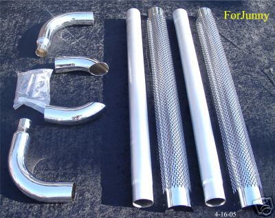

Patriot are the ones I ordered when they came they had a Thrush stamp on the mufflers. Dont remember the length but I am almost sure it was the longest ones they offered. You can see from my picture they are perfect length for the car. Comes with everything you need except the connection from the pipe to the headers. Comes with the chrome 90 bend to put it under the car then all you need is a small piece of flex pipe (about 12") to connect. No muffler needed built into the sidepipe gives a nice low grumble. Also looks cool as heck on a cold morning. They would never hook up to regular headers the 90 turn would be north of the end of the header tube.

The Patriot ones are what I was looking at. They seem to be popular. I've seen a kit for long tube headers where the exhaust actually makes a 180deg turn, then a 90 out to the side-pipe. Do the number of bends and the number of degrees they turn make a difference to exhaust like they do in heating duct work?

The straighter less turns in the system will definitely affect the flow. I'm afraid with a 180 degree bend and then a 90 I'd loose a lot of exhaust flow. On a stock application I don't think it's as critical. My motor is far from stock, could I afford to loose power with a twisty exhaust set up, probably.

For the record, I have full length hooker headers & side pipes.  The pipe does do a 180 and come forward, then 90° to the pipes.  The pipes are all mandrel bent 2 1/2 inch in three inch out.

I pulled off a perfectly good flowmaster exhaust to "back date" the look of the car. Â I think the patriots are only two inch in. Â When I bought mine (about 2005) the two options (from summit racing) were dynomax & patriot. I bought the dynomax's because they were 2 1/2" in (the same as I already had) Â I don't think the dynomax's are available any more so as far as I know the only option is patriot.

Side Pipes 50"L Chrome-plated Dual
SKU #: JCW-213158 Mfr #: H1050
Product Fit: Universal
Outlet Size: 3 in.
Material: Steel
Warranty: 1-year Patriot limited warranty
$311.42
Per Assembly
Ships: 2-3 business days
10% Off on orders over $0!
Use promo code FEBRUSH15
Add to Cart
These come in three inch. Believe these are the ones on my car. Not sure of the length though. If you want can run out later and measure.
