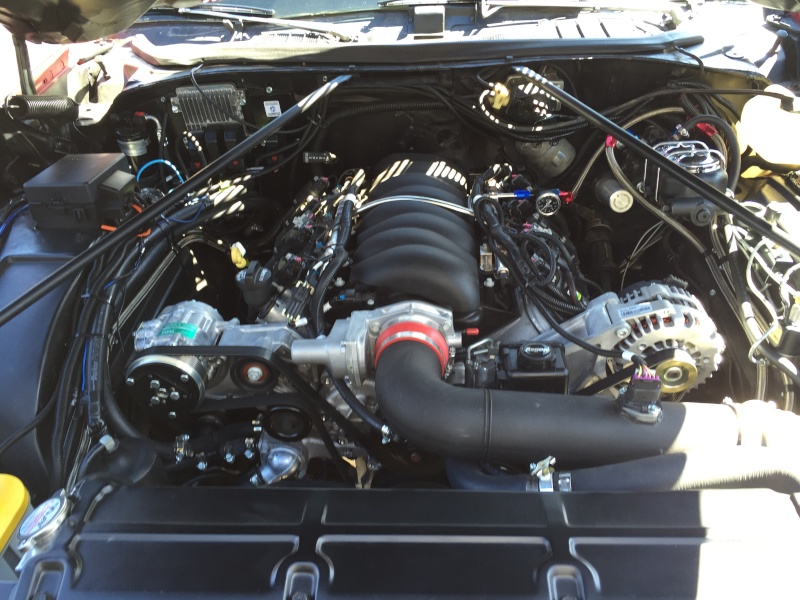

I Agree totally with you on the car we drove in high school just more modern. I too just installed a LS3 430 Connect and cruise package in my 73. I love the set up and have not even tried to adjust any thing yet. Get great mileage and goes good too. It also looks great under the hood if you ask me.
