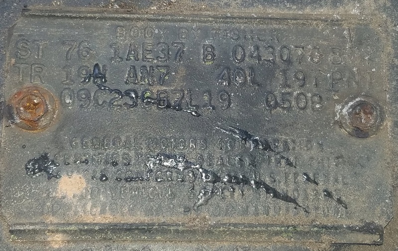

I recently picked up a nice solid project '76 Laguna S3, looking to see if anyone here can help with with some of the numbers on the COWL tag?
I am pretty familiar with all of what is on it but the numbers after the build date? I checked my books and resources available here, but nothing I saw helped?
After the 09C build date, the L19 is probably the lower black body strip, but any idea what the number(s) "23687" between the build date and the L19 are for? What is the "0508" at the end of that line for?

The 0508 is a continuance of the Vehicle Sequence Number (043070) shown above that on the tag...and, would be found in the upper right hand corner of your Build Sheet. What confuses me is that on my '75 Laguna, the six digit number (in my case 100494) is repeated just to the right of the date code; whereas on yours, there is a different number (23687). Other dissimilarity is that I have no idea what the 87 in front of the 0577 on my tag means as there is no reference to that on my Build Sheet. I do believe the L19 on your tag would reference the black body stripe. My Laguna was repainted by previous owner and I have no idea whether it came with the stripe originally (left 1/3 of my Build Sheet is missing, so don't know if it would have been referenced on that or not). Maybe this is the proof that mine didn't because it lacks this number?

I've looked at these in depth.  I have a 1973 Fisher Body manual that I refer to.  Fisher made the bodies and trim tags for all of our cars.  Your 76 trim tag is formatted the same as my 73 tag.  So I would have to say that the information would be the same.  I posted a pic below right from the fisher manual decoding the tag.
After the build date are the numbers that coincide with info at the fisher body plant.  They are just for reference.  There is a designation for a "lower" body color but that does not refer to a stripe color.  From what I've found. Also, all the paint info would be before the PNT on the second line.
For reference, my 73 (baltimore car) does not have any numbers between the date code on the left and the four numbers on the right. Nothing in the middle like yours. But I have read that those middle numbers are a sequential number used by the plant.

From what I have heard about COWL tags is they follow guidelines to a degree, but each plant also adds some specifics about the car being built that are not standardized between plants, thus the general info about build date, interior/exterior colors, vinyl roof are the same, but what we see in differences between our COWL tags are because the cars are built in different locations (i.e. Baltimore versus Fremont).
Like I said, the L19 on that line is easy assumption for the body stripe.....now we just have to figure out the others! :-)

Curious.  Where did you find info about the L19?   There is an L code already on the paint line. In 73 there is no designation for an ss stripe color on a cowl tag.

Joe73 wrote:Curious.  Where did you find info about the L19?   There is an L code already on the paint line.  In 73 there  is no designation for an ss stripe color on a cowl tag.
I did not find it any where, was an assumption since that is part of the build that is not documented, obviously I have the Black (code 19) Body stripes and the L would stand for lower, or in this case body side.

But on the paint line of the tag it already has 40L denoting the body color. I'd have to question if the L19 is a stripe color.

There is no real documentation that I have found about the line that starts with the date other than about the date code. All the rest is an assumption, unless someone has some documentation that I have not seen about that line?
19 is for black and no where is the stripe denoted, so I assume the 19L is for the Black Body strip. Why would it not be?

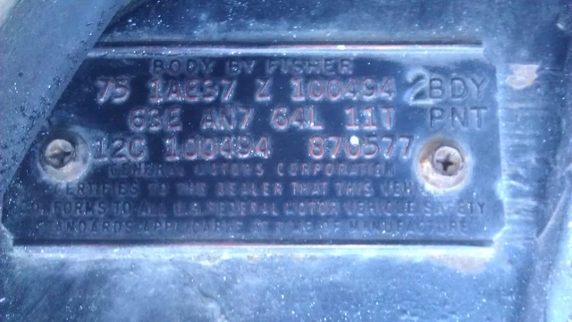

'76 Laguna S3 COWL Tag Info Empty Re: '76 Laguna S3 COWL Tag Info
Post by zot Mon Jan 29, 2018 9:46 pm
" alt="" />
Here are mine. All are from the Arlington, Tx plant.
Post by Mcarlo77 Mon Jan 29, 2018 10:08 pm
Here are mine. All are from the Arkington, Tx plant.[/quote]
Guess the question here is whether your '75 or '76 had the factory stripes since there's nothing on the cowl tags to identify such.
Post by zot Mon Jan 29, 2018 10:48 pm
Oops...Arlington Tx. Yes, both had white stripes from the factory.

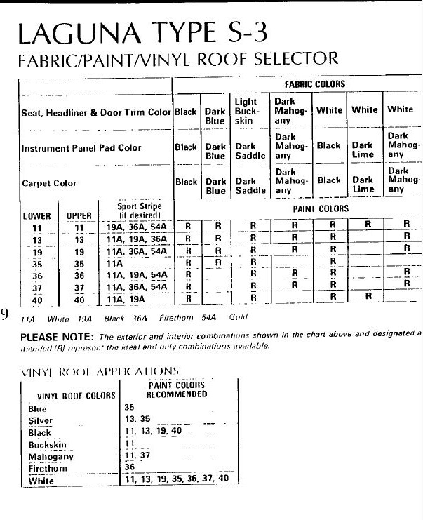

Still looking for an RPO for the stripe(s), buthere is something interesting that I found in the GM Brochure, says about the strip "if desired"? Also note that the "COLOR" code for the black side stripe associated with the body color code 40 (Poly Lime) is 19A....

OK, went through the '76 brochure again, best I could find for the RPO's for the stripes are here, looks like there were only 4 different colors:
White - 11A
Black - 19A
Firethorn - 36A
Gold - 54A
