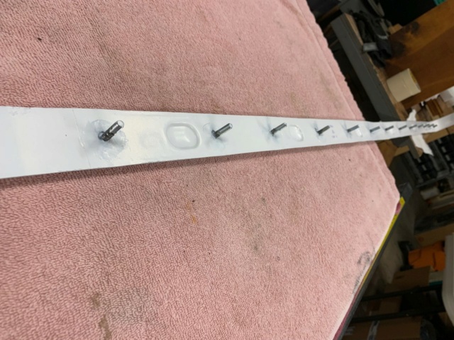

When I removed the impact strip from my rear bumper  (76 Laguna)
the bolts were so rusty they twisted out of the impact strip . I cleaned them out with lacquer thinner. I replaced the old studs with 1/4-20 x1 1/4 SS bolts. Used J-B weld steel reinforced epoxy to secure them. I let it cure for a couple days and used a die grinder to remove the excess epoxy. Painted the impact strip with Dupli-color  vinyl & fabric white paint.Impact strip Thumbn64

Thank you 77camino, I would  invert the strip when  put  back on. My impact strip will fit either way. I had to flatten the cavity  before epoxying the bolt in. Impact strip Thumbn67
