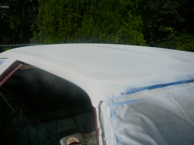

Ok...so I used my aluminum board with "clean sheets". Did end up storing the filler and hardener in a cooler with "ice packs". Slowed the set time down by about 5 minutes which was perfect for me. The can felt like a cold beer..LOL. Anyway...a few weeks have gone by and after sanding, sanding and you guessed it; more sanding I was able to do the first coat of primer on the roof today. Just in time too as it is now raining and I had to cover the car! Dried about an hour before the rain started. (Lucky!). I'm going to start a new thread about the car and post some before & after pics of various things but the 1st will be the roof! Here's a teaser.
