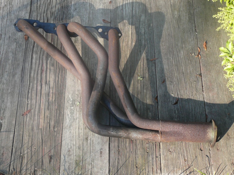

Do you guy's think they are worth saving? The other one is in similar condition. VHT paint maybe?

Good collectors, not banged up, not rotted through. I say have them blasted & get them coated.... or sand & paint if you must. One of my brothers had a good idea about bluing headers like you would a gun. Not sure how well this would turn out or how long it would last, but definitely different.

I think maybe a chimney brush might work to clean the inside. I'm going the sand & paint route I think but will try my little blaster unit to see if it does not bag them up too much. TY Dude.
