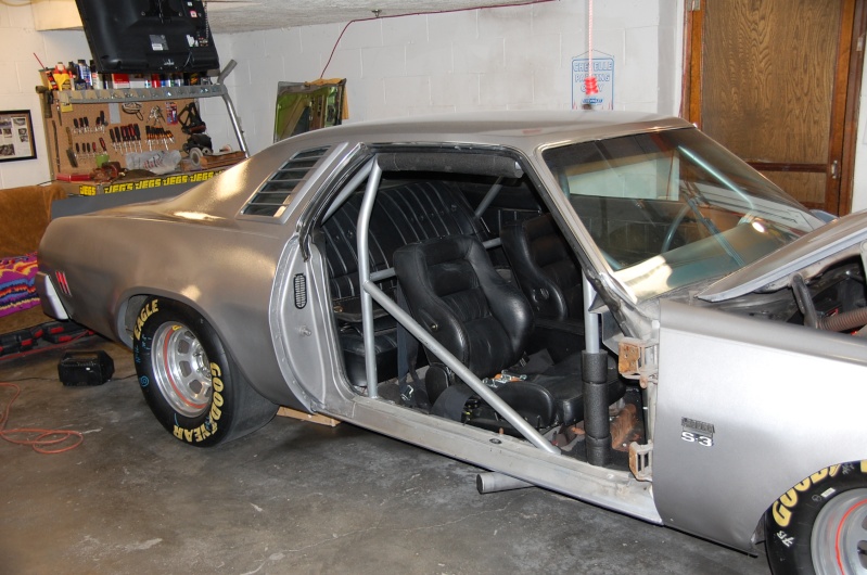

Post by Oldschool454 Mon Jul 28, 2014 12:09 am
New fiberglass doors Dsc_1314 test fitting. Getting the handles to work was a little trick since the fiberglass is much thicker than metal. not a direct bolt on.

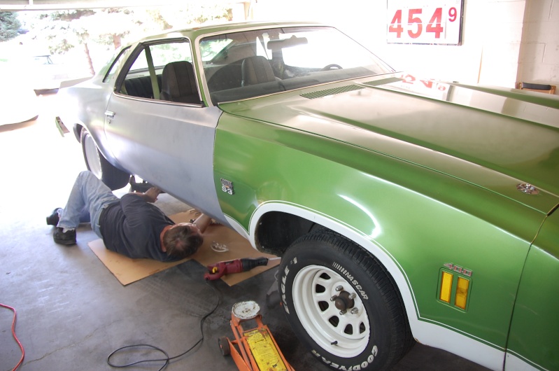

Post by Oldschool454 Mon Jul 28, 2014 6:04 pm
New fiberglass doors Dsc_4810 we spray bombed it like this and left it a few months. Right before I started sanding it down again.

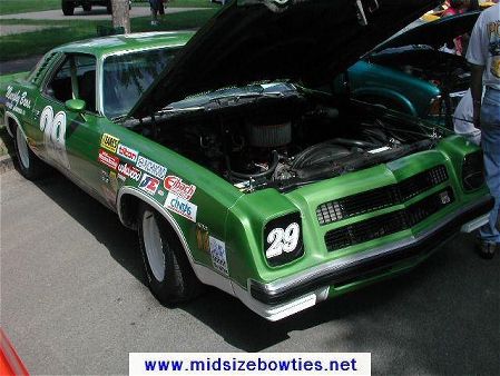

Post by Oldschool454 Mon Jul 28, 2014 6:13 pm
New fiberglass doors 1976-c10 In '03 he stickered it up and made the 8 hour drive up to minn for the car craft summer nats. One of the best road trips of my life!
