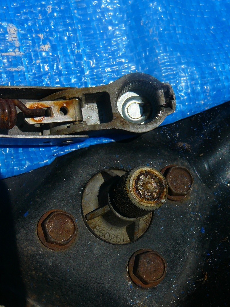

Well I did it & didn't destroy anything (a plus for sure!)  The tab is there- kind of hard to notice unless you're looking for it.  The pass side was very easy to do.
Wiper Arm Removal P1060013
My drivers side wiper is different, don't know if this is the same or not for the variety of these A-Body's but there was a little sliding tab on that side with a slightly different arm.  Used a body panel tool and needed the pry bars also. The smaller of the two-orange handles was required on the drivers side because of the shape of the cowl.

PS- remove the sliding tab thingy first, if you have a drivers arm like mine, then pry it off the splined post!

Mine is the same as yours.

Lmao...looks like you were prepared to do battle with those three pry bars!! Like most things, you do enough of these and it becomes much easier.
BTW...all driver side facotry arms have that retaining clip. Also, see these on '70-'71 "A" bodies.
