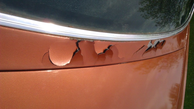

So, this is what I discovered when I removed the car cover from the Laguna this Spring. Was the first time in three winters I've owned the car that it sat outside; albeit, under this car cover. I've never seen anything like this on a car...complete delamination right down to bare metal in spots under the rear window. I just finished removing all the paint along that strip of metal and was struck with a couple observations:
1) The paint blisters were not due to a poor bond when car was repainted by previous owner as the original paint and factory primer are still present on the bottom side of the blistered chip...as well as where I removed the paint that hadn't blistered yet.
2) The metal has the look of galvanized; which I've noticed on a couple other Chevelles/Malibus/Lagunas I've come across. One recent example looks to be on the original Laguna g3chevy is selling .
(https://www.g3gm.com/t9366-my-latest-project-75-laguna#89831)
Is it really possible GM used galvanized in this area? Or, am I just mistaken in thinking it's galvanized? I would think galvanized would create adhesion problems...which may explain why some of these cars are prone to peeling. Can any of you guys who have painted your cars shed some light on this?

Looks like there is a bonding issue/poor prep with the new paint.
I never found galvanized panels when I stripoed my 73 to bare metal. If galvanized panels are found they can be treated with phosphoric acid to etch them or a good quality epoxy will do the trick.
What color is the backside of the flaking chips?

The backside of the chip is a charcoal gray. On top of that is the original Orange Poly paint. Then, a gray primer or sealer, a thk layer of cream colored primer and fimally, the top coat of orange paint. Chip measures about .025” thk.

I stripped my Malibu down to bare metal, and didn't notice any galvanized look to the metal. You may want to use some self-etching primer on the bare metal when you re-paint...

Steve, my '74 has the same galvanized lower window panel that you speak of. I once read somewhere (in original literature) that they did this to help the window channel from rotting out.

I would sand down that area, spray it with some 2k (not 1k) epoxy primer and then shoot it with paint. And if its metallic you will have to shoot it with clear on top of that.

Here it is, from the original 1974 dealer brochure. "Non corrosive rear panel"

Steve mine was Galvanized metal also. I buzzed it down metal prepped it with PHIX http://www.ppcbest.com/phix_treatment.htm
I did all the bare metal with Phix first. I have some here if you want to use it.

I would remove that rear window trim and see whats going on under there. I would bet its rusting and water worked its way under original paint then it froze and popped the paint off.
