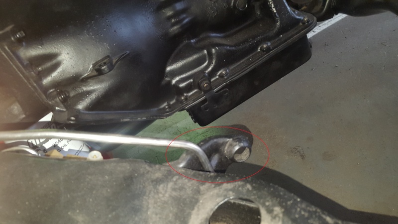

Hi guys, what is this bracket(??) used for?

Post by Mcarlo77 Sat Jun 18, 2016 7:00 pm
That supports your shift linkage from steering column.

Post by pila Sat Jun 18, 2016 8:00 pm
One of the frame braces on mine has a slight bend also. I'm not gonna worry about it, although it would be easy enough to bend it straight.
That bracket for the transmission shift linkage uses a tapered nylon bushing in it, held in place with a spring on the linkage rod.
Unless you are going to a floor shift, you are gonna need it, along with the rest of the linkage...

Post by Silentknight85 Sat Jun 18, 2016 8:37 pm
Oh alright. I have a floor shifter, so I've never seen it in use.

Post by Hawk03 Sat Jun 18, 2016 8:50 pm
The linkage connects to the steering column to change the gear selector on the column. You will still have to connect it even if you have an auto floor shiter to see what gear you are in if your gear selector is on the column. Probably not needed if you have a manual.

Post by fasrnur Sat Jun 18, 2016 8:56 pm
I believe it unbolts from the frame if you want to remove it. I kept it for my floor shifter so that I could have a neutral safety switch. http://www.pontiacsonline.com/SSJ%20Auto%20Stick%20and%20Computer.jpg
