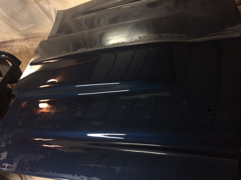

During the painting process, I decided to also shoot clear over the single stage.  This would give it a deeper shine and allow me to final sand and buff a little without affecting the metallic in the paint.  After the color was done, I went right to wet sanding and buffing....1974 Malibu project timeline - Page 2 Img_0513

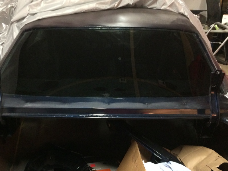

Now as winter 2014 rolls in, I started to work on getting the windows back in the car and more wet sanding.  I always wanted to tint the windows so I tinted the rear window 20% before I installed it.  I went with 80% on the opera windows.  I am leaving the windshield and the door glass at factory tint since it is an A/C car.

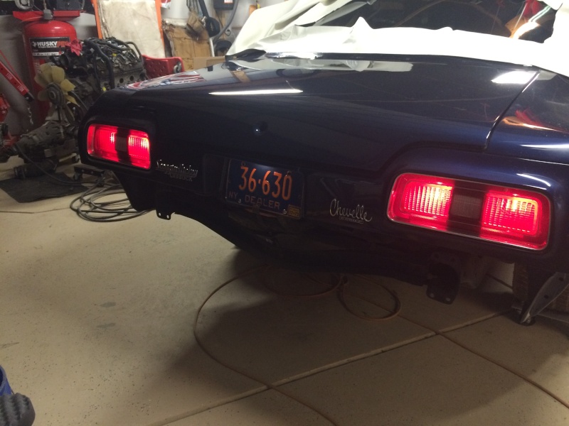

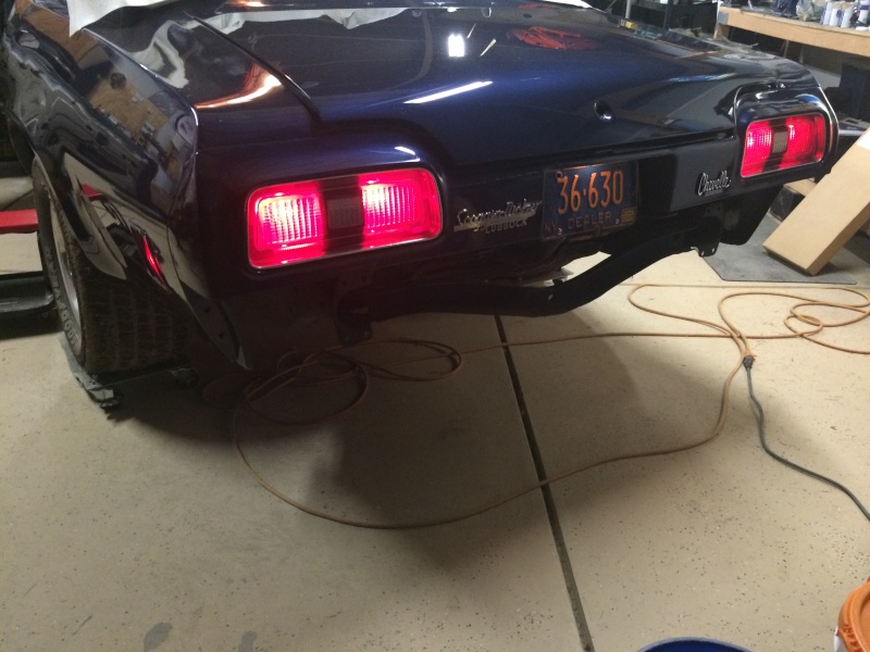

1974 Malibu project timeline - Page 2 Img_3512
Now into late summer of 2015, I started to work on polishing the trim, hooking up some lights in the rear of the car and preparing to install the vinyl top.
The top ended up being one of my largest jobs on the car.  The first one I custom ordered because I wanted 2 seams, equidistant from the top of the doors to the skyroof opening.  I did not want a seam across the skyroof.  It took me a year to find someone to make the top.  Once it came to me, I stretched it out over the car to remove wrinkles and check it for issues.  I found it was 10" to short, front to back. Mad   I ended up getting my money back and getting a new top besides that.  Installation was tricky enough without having a top that stopped 1/2 way down my rear window.1974 Malibu project timeline - Page 2 Img_3510
