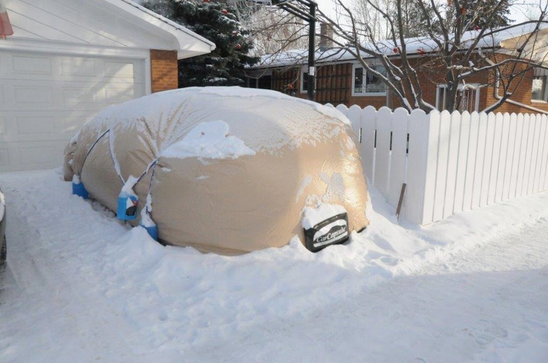

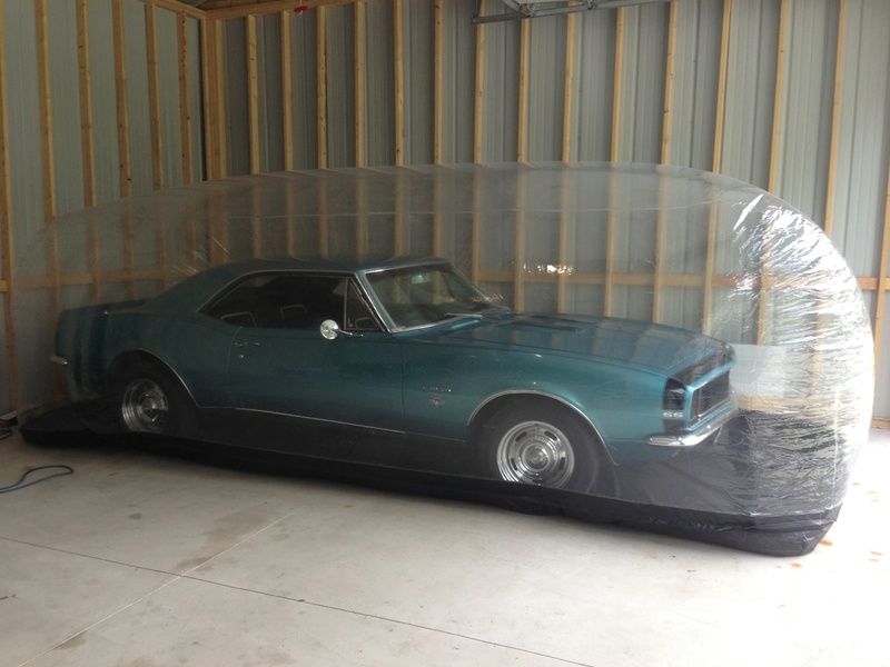

Post by Pontichev327 on Fri Aug 05, 2016 6:48 pm
I had these pictures of car capsules saved. Might work for you, I don't know. Storage info needed about storing outside Outdoo13
Storage info needed about storing outside Outdoo14
Storage info needed about storing outside Outdoo15
Storage info needed about storing outside Empty Re: Storage info needed about storing outside
Post by Hs1973 on Sat Aug 06, 2016 2:40 pm
I would never store a car i care about outside unless in a capsule. I have seen to Many Nice cars go bad over a short periode of time from Being sitting outside. Worst is sitting on grass with a tarp over it. Even a carport is better than nothing. As long as there is air flowing around and moisture can escape then you have as chance. Not far from me is a 59 caddy convertible that is sitting outside, it was a pretty decent restoreble car 5 years ago. Now from sitting under a tarp its close to Being to far gone. So If you have any chance at all to get it under any form of roof it would be a Wast improvement.
