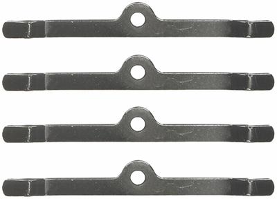

Valve cover may be warped. Do you hav e spreader bars to more evenly distribute the force of the valve cover bolts? They do help.
Re: New guy here from Florida
Long washers (for lack of another term) that go on the cover, under the bolt, that spread the load. If a steel valve cover gets over tightened it pulls down under the bolts and lifts her in other areas causing leaks. If you take the cover off and look at the flange it has to all be flat, if around the bolt holes is peened you found the problem. Hope this helps.
They're these: valve cover load spreaders
They effectively give you eight points of pressure along the rail instead of four, and are more evenly spread out.

thatfnthing wrote:They're these: valve cover load spreaders
Be sure to staighten the valve cover sealing edges first, all the holes have to be flat with the rest of the rim, and careful not to slide the gasket when installing. Come down FLAT on the heads. AND DON"T OVER tighten them.
