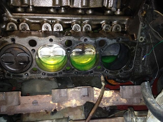

This is what the engine looked like after pulling the driver side head.

I didn't drain the block before removing the heads, so there may not have been that much coolant in the cylinders before I loosened the bolts. I started it the following day after we got back and drove the car to get the vin inspection done. This engine was not built for horsepower. The pistons are .055 below deck height.

Looks like stock 8.5:1 dished pistons. Lifter valley looks good.

It looks like a fresh rebuild. There is no ring ridge, just a little carbon build up where the piston crown stops.
8.5:1 is optimistic in reality. The heads are 76 cc models. The math puts me at under 8:1.
I am currently looking for a set of 64-68 cc heads. Which should put me at 8.7:1 or so.
