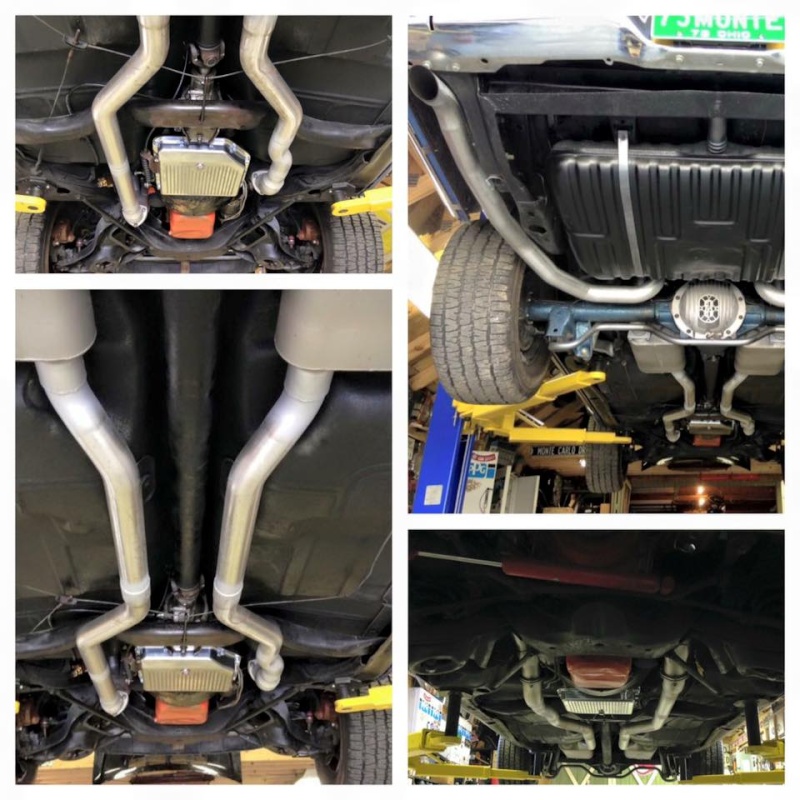

Post by 1973montec Tue Jan 12, 2016 4:13 pm
borrowed from Chris' facebook page..
2-1/2 mandrel bent with 50 series flowmaster. no modifications to shocks,springs,or control arms..
fits like a glove.
Opinions on tailpipe exit - Page 2 Chris_11
Opinions on tailpipe exit - Page 2 Cris_x10

Post by Joe73 Tue Jan 12, 2016 5:04 pm
I think thats a pypes system.

Post by Limey SE Tue Jan 12, 2016 7:58 pm
Joe73 wrote:I think thats a pypes system.
IIRC correctly the tails were box pypes the rest was mandrel bent at local shop

Post by Hawk03 Tue Jan 12, 2016 8:19 pm
Its a Pypes system with Flowmaster 50 mufflers.
1973 454 MONTE wrote: I have a pypes system on mine with flowmaster 50s.
1973 454 MONTE wrote:its 2 1/2 from headers to bumper. no X pipe. original muffs were in-offset out-center. the tails are accually listed for a 72 monte,but fit awesome,but you need a offset offset muff.. the first t-pipes they sent were straight from axel to bumper,i did not like that. so he got on the horn and talked to a pypes rep.the fit in unbelievable..

Post by Limey SE Tue Jan 12, 2016 8:28 pm
Well hell guess I cant recall correctly LOL
