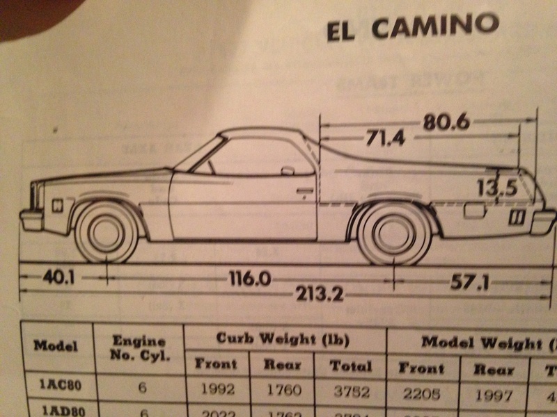

I don't know what the bumper to rear wheel distance would be, but the wheelbase should be 116". I would think the bumper would clear height-wise most transports unless it has some kind of wall or obstruction that it can't get past. Welcome to G3GM.

Measured my 77 El Camino, don't know if it is the same as 73. From my bumper guards to rear wheel is 164 inches.
According to the factory specs it would be 156.1 inches to center of rear wheel.

Hi
Super thanks, looking at your pic and looks like it, add say 4" safe keeping to keep rear wheel from falling off would be 160". Bed is 159.5" and that is a transporter so the cab is in front, if it was a trailer no problem with bit overhang in the front but when a transporter/hauler the cab is kinda hard. Think removing the front bumper will help to have some safety margin. Thanks for all the support from you all.
