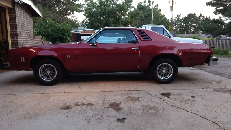

Well, I guess I will get started on a build thread for my car. It is right now in mechanically stock condition complete with the original catalytic convertor. It has had a repaint/restoration in 1994 by a previous owner where they changed the car's visuals completely. It was originally a blue/white stripe exterior with a blue/white interior. Now it is a 1994 Cadillac red or maroon, and had a gray interior that I started changing over to black, and have yet to finish it.
Part of the reason for stopping was indecision on my part, because everything mechanical needs attention. It still starts and drives fine, but all bushings are worn out, stuff leaks, and the engine smokes a little (likely valve stem seals, because it does clear up after a week or so of daily driving). The power must be increased, because 400 ci should be quicker than this thing is. That and lack of money for budgeting out the rest of the build.
But I knew I would not sell this car unless I got into a severe situation, and now I am able to budget for finishing this thing.
Here is one of the early pics of the car

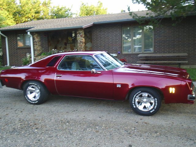

I have recently bought new rims for it, because the offset for the rear wheels put the tire into the outer wheelwell on compression. Had to keep air in the shocks to keep the tire from getting cut.
So I got these, with shocks aired up and without air
76 Laguna progress 76_lag10
76 Laguna progress 76lagu10
Street Cred : 53
76 Laguna progress Empty Re: 76 Laguna progress
Post by bigredlaguna Sun Aug 27, 2017 10:26 pm
These rims aren't as wide in the back so it can clear the wheelwell and I can use normal shocks for a normal car ride quality. As for the engine, I had a 383 that I had under the counter freshened up. It is still old school with early smog heads and a 280 magnum cam. I am considering having a set of vortec heads built for it, but I think I will run these for a while.

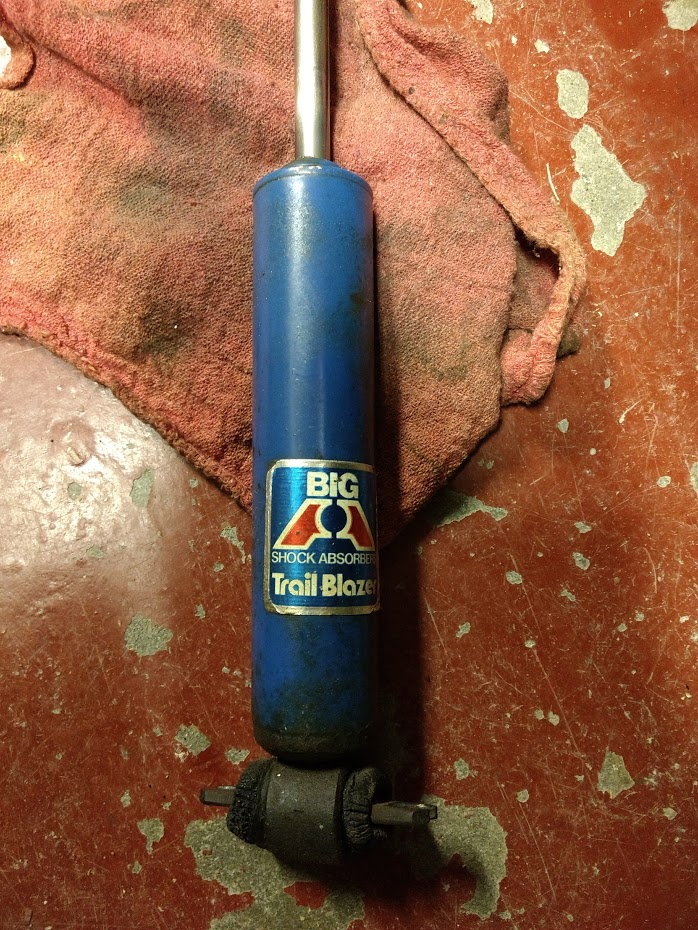

Beyond that, how about these dampers?
76 Laguna progress Lagsus11
I really don't know if those are the factory shocks, but these are the numbers on them for posterity reasons.
76 Laguna progress Lagsus12

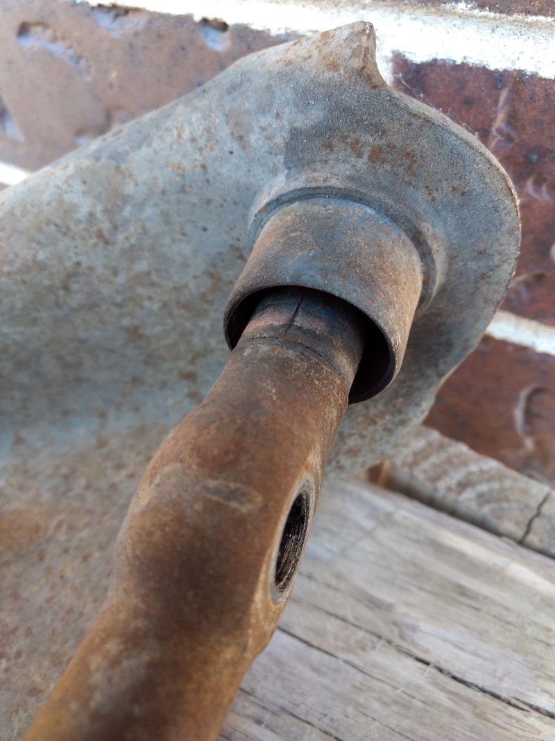

Figured I would share some pics of the front a-arm bushings. They we're really bad.
76 Laguna progress Img_2010
76 Laguna progress Img_2011
Like a Star @ heaven 76 Laguna progress Img_2012
76 Laguna progress Img_2013

Post by thatfnthing Mon Apr 09, 2018 9:00 am
Wow, those were even worse than mine, and mine sounded like someone hit the frame with a hammer every time you hit a bump.
