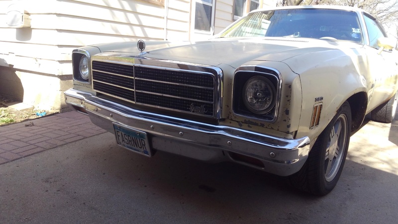

I thought I was in heaven when I put 2" drop springs all the way around on mine. I was told they were 2" springs, but in defense of the person that I got them from, I don't think he ever had them in his car and was told that they were only a 2" drop. It looked great when I finished, but when I took it for it's first test drive I couldn't even go over a small pebble without bottoming out. Bummer! Had to replace the rear springs so that I could drive it to work this week. Different springs to bring it up will be going in this weekend.
![76 Laguna progress - Page 2 Kimg0312](https://i.servimg.com/u/f62/14/35/09/33/kimg0312.jpg)
This is with drop springs up front and Impala SS springs in the rear. SS springs will go up front.

I don't want to put down that low, just reduce the gap between the tire and the wheel well and perhaps bring the back up a bit. The original springs gave it a nose up look that I don't care for.
I got some springs for the front that start out at 500 lbs/inch. If I need to trim those, they will get a higher rate as a result so that should mitigate the problem of clearance a bit. I also got some rear springs that are 198 lbs/inch to try out for the back.
The fronts are moog 5534, the rear are moog 6381. The front springs are for a 1973 Buick Regal/Century with a 455 and the rear are for a similar year station wagon or sedan.
