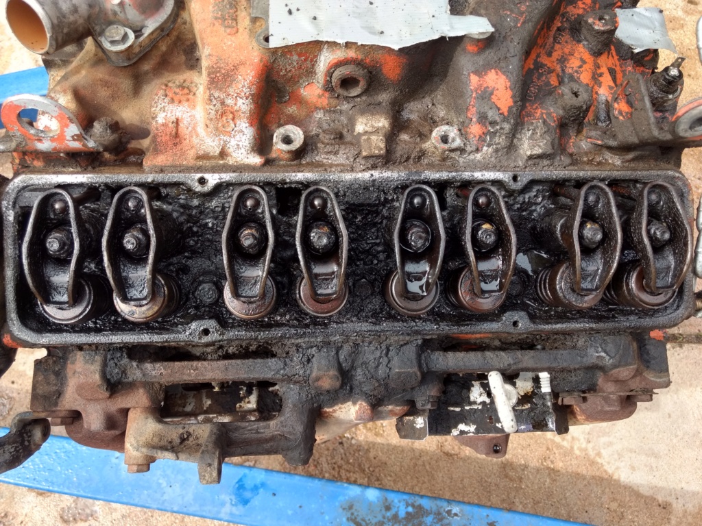

I have yet to hear back from the machinist about the condition of the original engine, but after unloading it, his tear down guy came back after just 10 minutes and said it would need a new crank at the least. This was due to him being able to pull the harmonic balancer off by hand. I neglected to take a pic of the flex plate, but on my way out he showed me that it was cracked almost all the way around the bolt pattern. I did take a pic of the top of the head. I don't know if this block will be viable.
The forward passenger side oil return hole was completely blocked

man i have never seen a trans damaged like this without making all kinds of noise. And also a cracked flexplate plus a bad crank on top makes me think you just dodged a major bullit. Hope you get it back on the Road soon.

Wow HS1973 is right you dodged a very big Bullet with Laguna motor printed on it .... Hope everything can be saved for you sir

Im guessing po did not do much in oilchange, at least not on a regular basis. Its funny though that some of these chevy motors can actually be running Real good. And hen you take them apart some day everything just disintigrades and falls apart. I saw a 350 one time that was running ok, and when we took the valvecover off it was so caked you could not see the valvetrain.

This car was first purchased by a mature female. I don't know if it was the last car she ever bought, but she kept until she passed away. Her daughter acquired the car from her estate and during her ownership, the car was changed from its original blue/white to the color it currently is. If you buy in to the stereotype of a female car owner, well-- it's no surprise the engine ended up as coked as it is.
It might be just a symptom of the time this car was built also. Oil technology, mass production tolerances, fuel distribution issues inherent with carburetion were all stacked against this engine. This is what I am going with.
