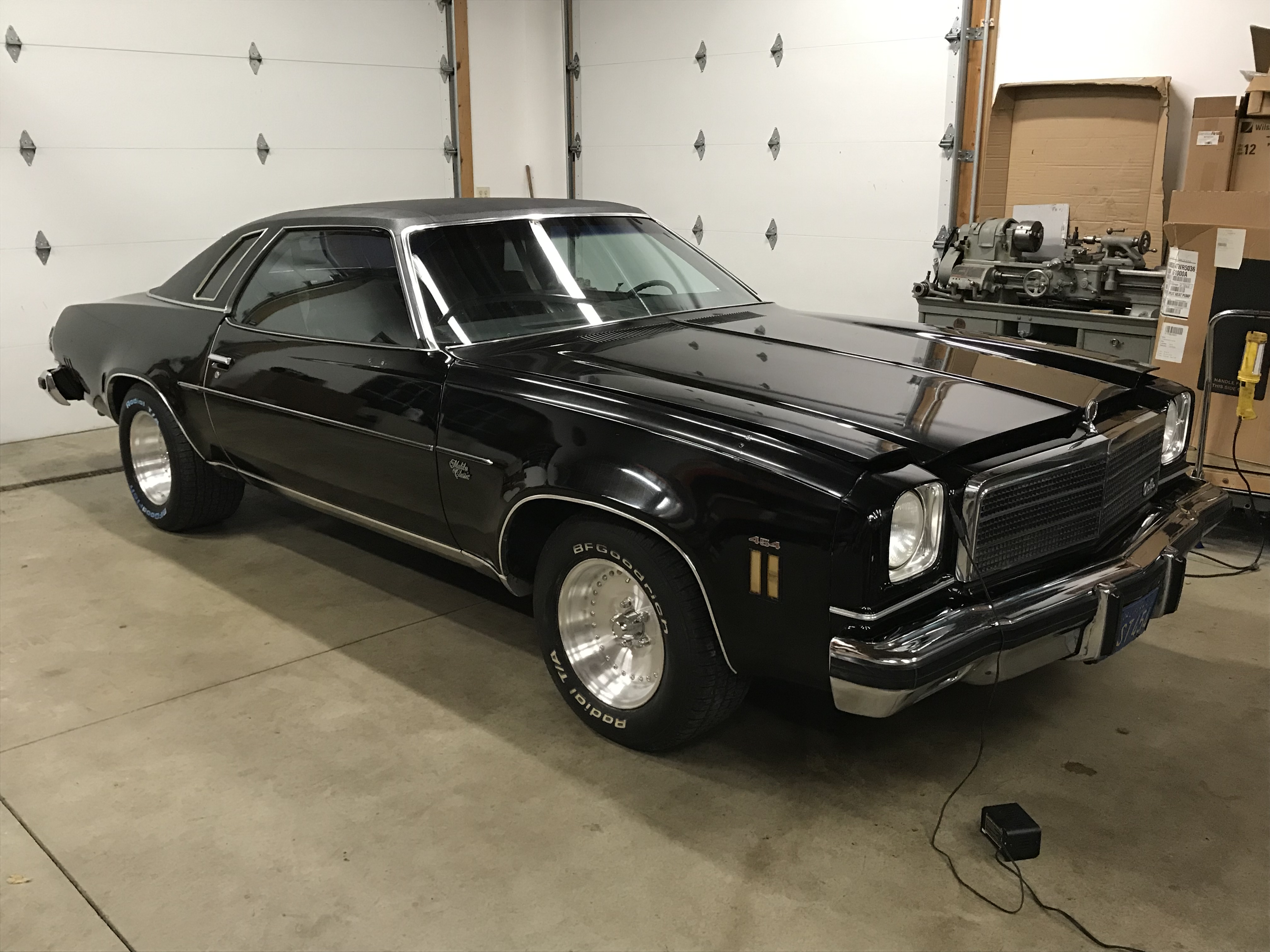

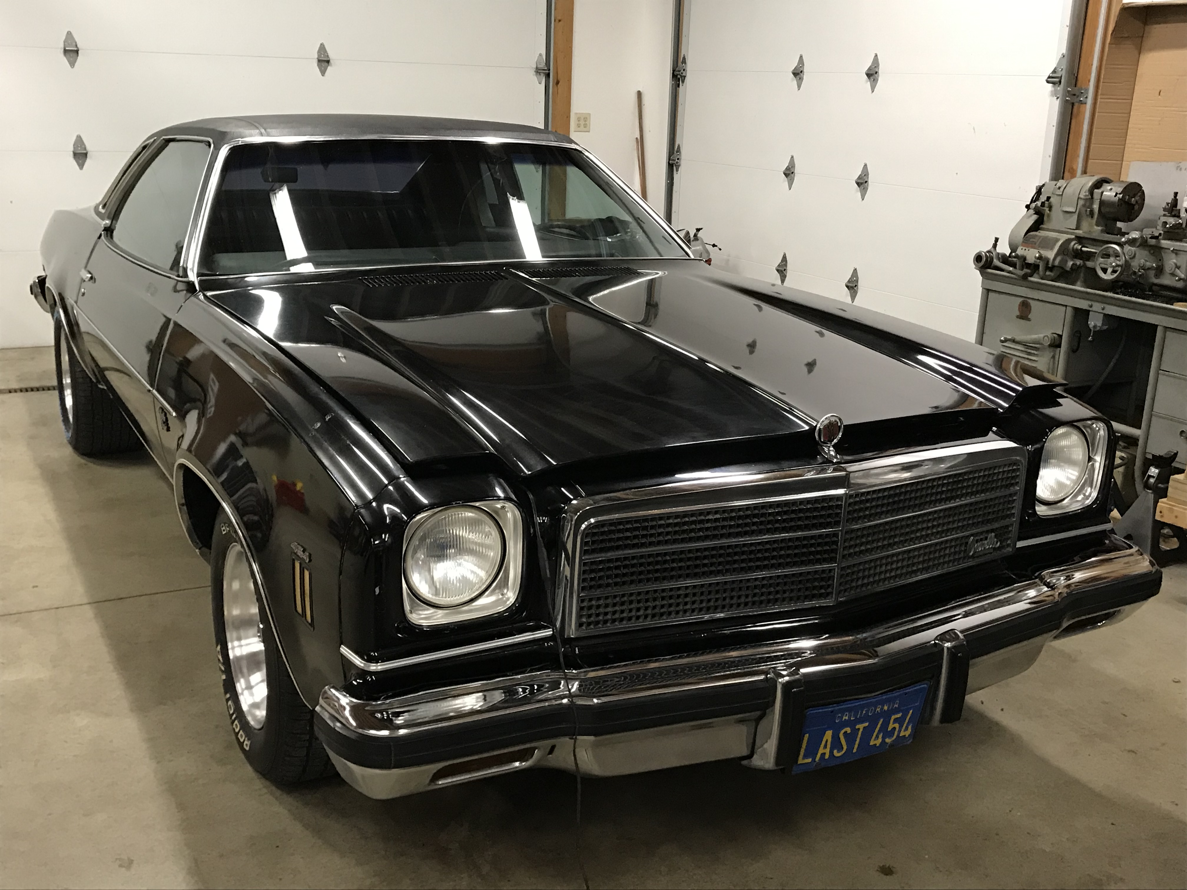

My black Chevelle has been sitting for almost 10 years. When we brought it home, it was a running but we wouldn't dare to venture outside of the 6 mile radius of my shop. Everything leaked and it was electrically scary. Many major issues have been addressed over the last decade but this car kept getting pushed back in the corner for some other project of the week. This spring, I have tried to remain focused on only this one. I didn’t want to restore it, just sort out the crazy cobbled stuff that happens over the years of different owners. Updates include an engine rebuild with all the major LS6 components, complete electrical harness rebuild, new cooling system, and some new era correct shoes to fill the wheel wells. There is always more to do but we are in the driver category now and it's a step forward. It needs some new paint since the mid-80s lacquer has seen better days. Hopefully, we can get some miles in before the winter strikes.

Engine rebuilt. It had been apart a couple of times and had some good stuff in it. Biggest upgrade was rectangular port heads from an '80 crate motor, Comp Cams LS6+ cam, LS6 dual plane, Quickfuel 780, and GM Performance / MSD HEI with Rev Limiter. Bottom end has a GM steel crank, LS6 rods with big bolts, and set of Mahle pistons. I wanted to definitely improve performance but also return the 1974 original appearance. All the magazine project articles would emphasize that 'the heads have never been removed and the engine had never been out of the car.' I wanted it to have that look again without over-restoring it.

g3chevy wrote:Yes, the car still looks great! Engine bay looks even better. But the plates, "LAST 454"? I thought 1975 was the last year of the 454?
Yeah I know, last year the big block 'nationwide' was 1975.
Last year for big block in the People's Republic of California was 1974.
I watch for 1975 big block Chevelle and El Camino, and they are super rare.
