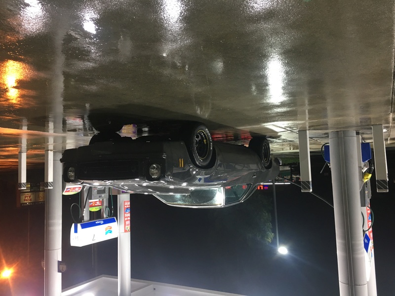

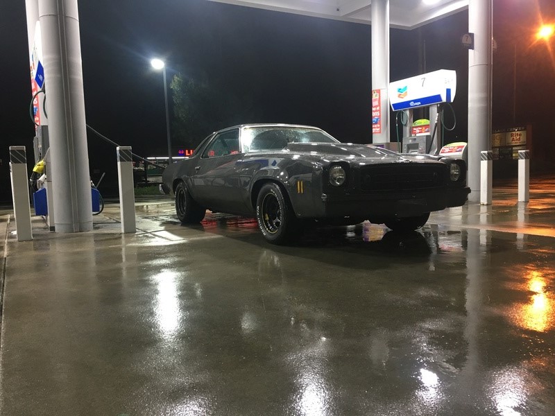

This is my chevelle right now as it sits it has a 350 small block never been touched bottom end. Edelbrock EPS intake, edelbrock 600cfm carb, HEI distributor I rebuilt, Summit racing long tube headers. Muncie 4-speed I rebuilt with a hurst competitor plus shifter. 2.73s out back.

Those must be sticky new tires to get it to stick to the ceiling.
mikidymac- G3GM Member
Re: 1974 chevelle build thread
Hahaha ! looks like something I would do, getting pics posted !

Very nice looking car sir. Glass hood, or scoop boned onto stock hood?
Looks great! Bet it turns a lot of heads...
