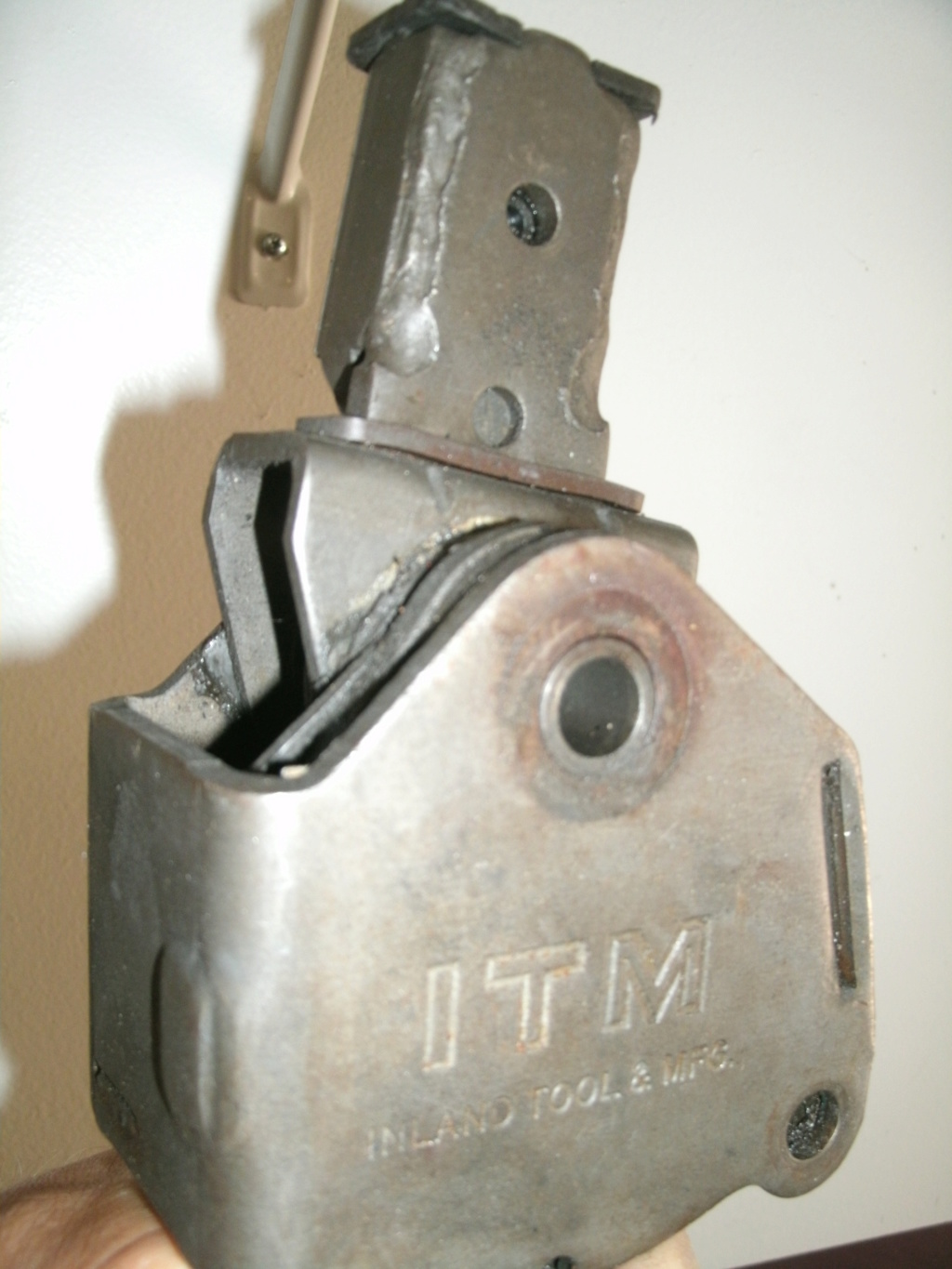

Just to add to the shifter info.  The factory ITM shifter handle mounting is almost perpendicular to the shifter body.  Unlike camaros/firebirds that are tilted to the passenger side.  Both the muncie and saginaws in 73-74 used the same shifter, mounting plate and trans levers (unsure about the reverse lever).  And the rods would be different because muncies have the reverse on the tail shaft and saginaws have it on the side cover.
If you need any sketches of the the shifter handle or any other info, I have my original muncie itm complete with rods and handle and another saginaw itm shifter both complete for either trans.
Heres a pic of the ITM shifter rear view that shows the handle socket offset.
factory 4-speed shifter  Shifte10
factory 4-speed shifter  Shifte11
