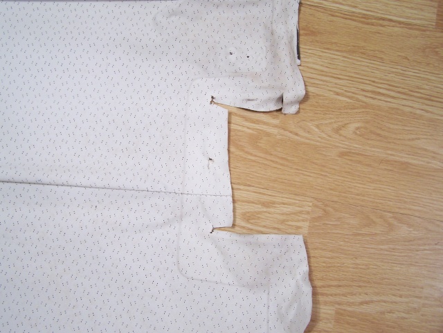

As I'm about to install the headliner in my Monte I have some questions:
1. Can I just attach all the bow clips and put the panels on later, or should it be done at the same time?
2. Is glue only applied in the front and rear?
3. Do the seat belt retractors go under the headliner, or do they clamp it against the roof. If the latter, is it enough to cut holes for the bolts, or should i cut a big square for the retractor?

I believe you are over-thinking this. All I know is, when removing nice headliners that I am trying to preserve, I always remove the retractors first as there is always at least one edge that is pinched under the retractor. You've got at least 1-2" of overlap with the retractor trim pc, so you don't need to be precise on the cut. If it were me, I'd glue the headliner in place and do the trim cut afterwards. Start with a smaller cutout and increase the size as needed to get the retractor in place. I've got a used headliner I could show you if that would be of any help.

Would be great If you could take a picture of the area. But in a way I got the answer in your post, as I wondered if the retractor had a function of clamping the headliner down, and thus tightening it against the roof in the sides.
Thanks

Here is a pic of a cutout for the retractor on the driver side (looking at it from the front). If you look closely, you can see the shadow line where the retractor trim pc covers the opening. As you can see, the cut doesn't need to be that precise. Honestly, I don't think they intended to purposely pinch the fabric down with the retractor.

That picture was very good, I think I've got a good plan on how to do it now. Thank you Mcarlo77!
