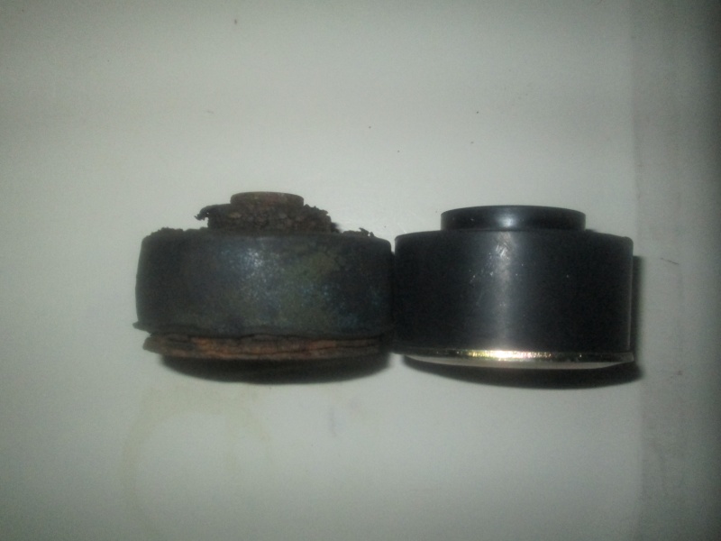

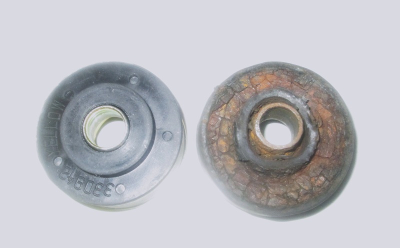

Guys just picked up a set of rubber body bushings for a 68-72 GTO convertible. Complete kit, WITH sleeves, for $68 to my door. Includes the rad support bushings as well. The kit is sold by yearone, part number MH5051. Sleeves are well made and are thicker steel than the factory ones.
I've been matching them up with a set of used bushings I have. I know that used bushings are "sqwished" and not of original size. But here's what I've found. I find that the new bushings are about 1/8" shorter in height and about 3/16" smaller in diameter all around. Meaning that they are about 3/8" smaller in overall diameter than the stock ones. That is matching them up sleeve to sleeve.
I was wondering about others experiences when replacing your bushings. Poly or rubber, did you find any differences in thickness or diameters?? I tried them in the frame holes and they fit perfect so I have no problem using them. I dont see any problem with them being slightly shorter because they're all like that. I matched them up side by side. Just basically wondering about the diameter.
I plan on wiping these new sleeves down with some wax and grease remover and hitting them with some either black or clear paint for some protection.
Opinions?
Opinions?

Thats what I've read as well. I see no problems with them at all. I like the way the sleeves are made too. I'm just curious as to the overall diameter being 3/8" smaller which is only 3/16" smaller around. By being a little smaller in diameter they dont seem as "beefy" as original GM ones. Funny thing too, even though yearone lists them as 68-72 GTO, four of the bushings are molded with the word chevrolet on them.

Budman, so the set you used were slightly smaller in diameter?
Sublime, my yearone MH5051 kit is complete. Its a rubber kit. It has 12 bolt through bushings and 4 solid rubber bushings that go 2 above the rear axle and 2 for the center of the door area. No bolts on those.
