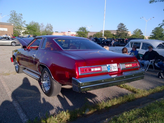

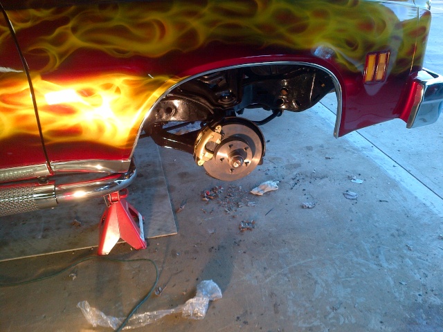

Winter project went into overtime. New suspension brakes steering pretty much everything underneath. Even had the wife freshly undercoat during the project. Thanks to some parts from Brownbomber77 and Rock Auto it now stands correctly at least in my eyes anyhow. In case any body wants to know the new rear stance came by new load leveler springs for the 77 Malibu with 2" polyurethane spacers from a 2006 Chevy suburban. Took a chance they would fit as the guy on Ebay said they wouldnt.

so let me guess! bigger sway bars also Shocked .. those SS's would of looked good with some slotted/drilled rotors behind them. Thumbs up

1973 454 MONTE wrote: so let me guess! bigger sway bars also Shocked .. those SS's would of looked good with some slotted/drilled rotors behind them. Thumbs up
good job
HMMM I would assume so yes ......

What front springs did you go for? Standard or Heavy duty? Big block or small block? As for the rear springs, I dont see load leveler listed or did you use cargo coils?

Front are stock small block. Rear are the cargo coils. Sorry. Mince on words.
