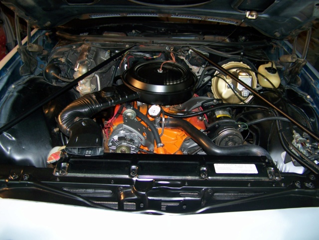

In the photo of your engine bay, I see you have HEI and AC. Even if the AC doesn't work and/or you're not using it, I would encourage you to upgrade your factory 10SI alternator to a 12SI. It's a simple drop-in upgrade, no mods. May as well upgrade your charge wire from the factory 10-gauge to an 8-gauge wire. These two upgrades will give you a more reliable, robust charging system that doesn't have to work as hard as the original.jpowen49 wrote:The alternator is 61 amp, I have no accessories…
zucchi- G3GM Member
Re: 76 Laguna parked in 2002
It`s on my list of things to do.
