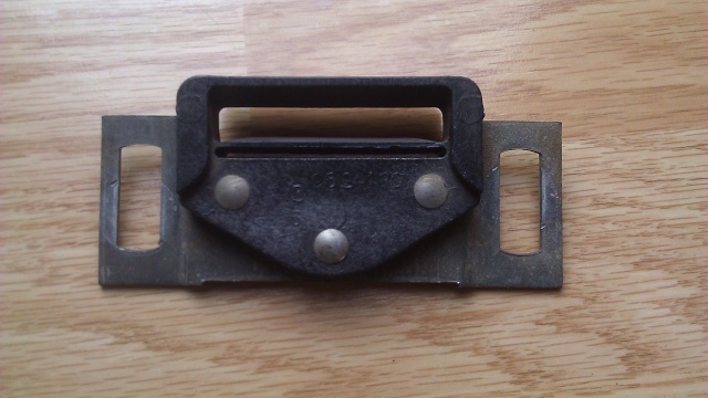

If all your nuts/bolts that hold the glass and channels in place are tight, here's a likely culprit.  Sits on top of the door frame and works in conjunction with the window guide as the window is rolled up/down.  That center "rib" is always broken and can allow window to rattle.
Door Latch Mechanisms Window10
Also, I've seen where the linkage rod from the inner door handle to latch mechanism is loose and rattling when one or both of the plastic retainer sleeves that secure it to the door frame are broken.
P.S. If anyone needs one of these window guide brkts, let me know. I've found a few good ones.
