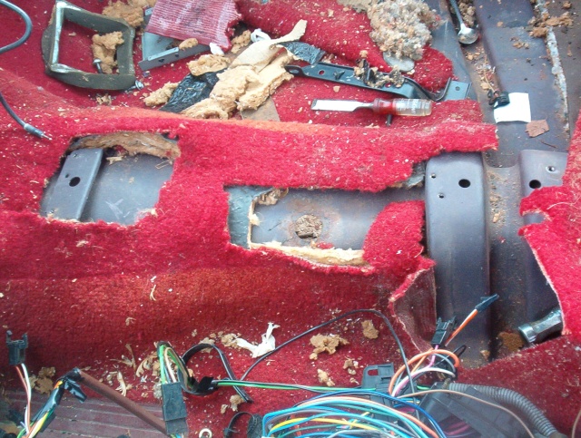

Hey Guys, Last week I had some vacation time I had to burn so I spent it working on my 73, I pulled the dash out and replaced it (Thanks Limey for the help in getting Troy's phone #) with a not perfect but nice dash from a 73 El Camino, (got the whole dash but used the pad only because the lower section on mine was in nicer shape ) I also refurbished my insterument cluster, polished the gage windows, put in my rebuilt tach from the Tachman (no haters please I know it was a rip at $250 but WTF are you going to do) and swapped my column with an nice tilt column from a 76 442 (thanks John M AKA Dynchel for your help with this) All I have left is installing (back to factory console/shifter setup from a B&M)
Here's my question"
Is the console installed over the carpet or should I cut the carpet over each mounting bracket and bolt it directly? t doesn't seam to fit nice over the carpet. Any body know how it was done from the factory? Thanks in advance!

I put in new carpet 2 years ago. As I recall , the carpet was just cut around the mounting brackets from factory. That too , is the way I reinstalled the carpet with no issues and the carpet lays nicely over the "hump". I did not notice abnormal bunching of the material.

I replaced the carpet 2 years ago and got the (plush) option and its very nice but the vacuum forming sucked, no matter what I did it didn't lay down around the hump, especially where the front section overlaps the back. I hope its not a problem now. Ill pull the carpet and see how the console fits the mounting brackets just to be sure.

This pic of a floor shift Cutlass might help show how the carpet was cut. Look closely and you can see the outline of the console base where carpet has faded.
