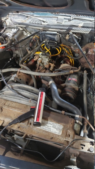

After a bit of a vacation off the road again due to us moving, I'm happy to report the wagon is back on the road again. I recently removed the old electronic Accel distributor and installed a nice HEI distributor and a set of wires. A few of the old wires had tape on them, that I had assumed was the previous owners way of marking them... but it turned out the wires had been bit in half by a rodent and the tape held them together, lol.
I put about 500 miles on it in the last week or so. It runs and drives fantastic with the exception of the nasty tip-in stumble that it still has. I guess I'll try replacing the accelerator pump again. I have to keep talking myself out of a 4 bbl. The engine makes enough power to have a little fun, I really don't need to go down the slippery slope of engine modifications.

bucket wrote:It runs and drives fantastic with the exception of the nasty tip-in stumble that it still has. I guess I'll try replacing the accelerator pump again. I have to keep talking myself out of a 4 bbl.
From looking at the one photo above of the engine, it appears yours is box-stock with a 2-bbl carb. If that's the case, I agree with 76Chevelle2Tone but go a bit further. The cars of this era are very sensitive to engine vacuum status. Unless everything is tight, snug, and buttoned up, engine operation will be less then optimal and ideal. Understand that every vacuum connection outside of the transmission modulator and distributor advance is compensated by adjusting the carb for "controlled" vacuum leaks. With that said, you may need to run the stock air cleaner with the vacuum lines that go the heat riser thingy (the one photo doesn't show what kind of air cleaner you're running). This whole vacuum thing is a marvelous balancing act that's as robust as it's weakest link. All it takes is for one failure anywhere in the system and…
If you really think the problem lies with your accelerator pump then swap the entire carb with a known, good 2-bbl. Otherwise, you'll need to go down the slippery slope of replacing every vacuum line, modulator, check valve, servo, filter (i.e. the bottom of the carbon canister), etc.

So, the hunt for the stumble continues.
As a refresher to what happened in the past, I rebuilt the carb and bypassed what little vacuum lines there were. I still aim to run the stock air cleaner, but it's badly rusted and needs a restoration. So I'm running a little Eddy air cleaner that I ran on my Impala's 2bbl 327 back in the 90's. Anyway, when I first got the car running it ran great with no stumbles at all. Then I went out of town for a couple months and then when I drove the car, it had a mild stumble. With more driving, the stumble became worse.
Yesterday I pulled the carb apart again, looking specifically at the accelerator pump circuit and also the transition slots in the throttle bores. I found absolutely nothing wrong. Float level was also fine. Accelerator pump shot was also good. So I put it back together and of course, it ran the same. However, I later realized that I neglected to check out the off-idle discharge holes, so my next step is to make sure those are clear.
