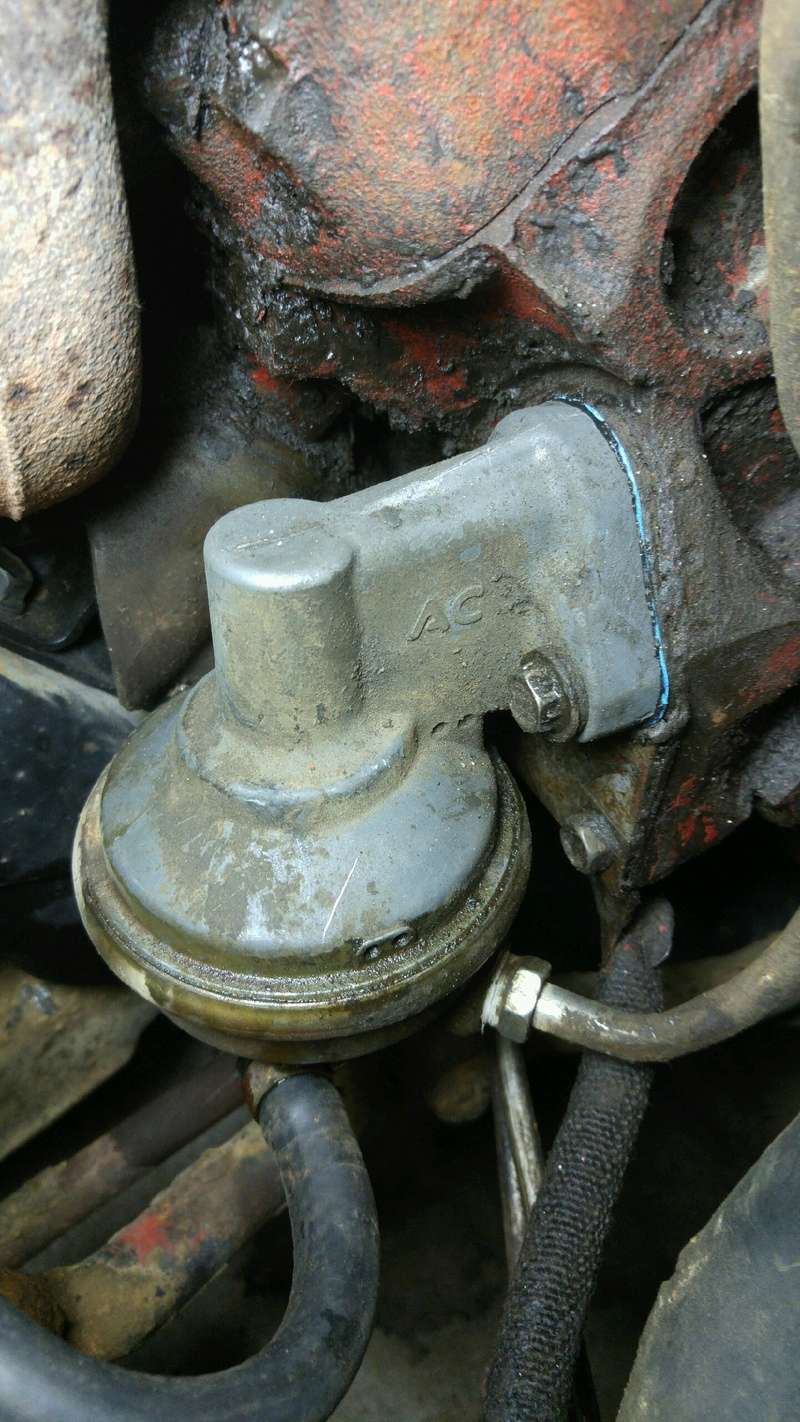

So I have been working on my 77 Malibu project with 54k original miles. I finally got around to replacing a factory original AC fuel pump that was seeping fuel from seam around the bottom. After the install I immediately noticed the engine running rough. The carburetor was flooding badly and choking the engine. I suspected the carb needed to be rebuilt so I took the easy way out and bought a rebuilt unit from O'Reilly's Auto Parts. Installed it, same problem. The new fuel pump was a Spectra Premium from Rock Auto. Fortunately the original shipment they sent did not include gaskets so they sent a new fuel pump with gaskets at no charge. So having the extra fuel pump I switched it out and corrected the problem. Then installed my old carb and it ran even better than the rebuilt from O'Reilly's. Never seen a brand new fuel pump put out that much pressure before. Has anyone else experienced this?
